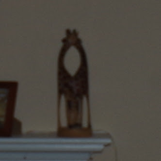

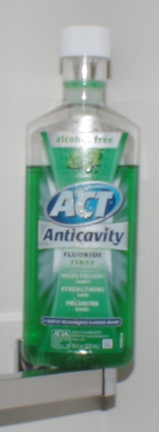

I recently picked up an old Accura 12mm Fisheye f8. (<Link is to forum review for this lens.) It's a T-mount, and I'm using a T > K bayonet mount adapter.
I wasn't expecting stellar results, and I figured the softness was just due to the nature of a budget fisheye. I was getting better results at f16 than f8, but it still was quite soft.
At f16 and 12mm on a K-30, according to my DOF calculator, at 3' to subject I should have focus from about 1' to infinity. It's for this kind of DOF that there is no focus ring on the lens. But I thought maybe I had been off somehow, and so I unscrewed the lens (ie, the T < K adapter part) a few turns which effectively moved the lens further away from the sensor about 1mm or so. And... now the pic was much, much sharper. See the mouthwash examples below which were about 3' to subject. (center crop)
Thinking it might just be that it was close, I tried again, and the giraffe figurine pics are taken from about 15 feet away. Same deal. (extreme center crop)
So is this a fault of the lens? Of the adapter?
I suppose I could devise some kind of washer to put between the lens and the adapter so that I can tighten the lens so it isn't loose. Or is there something else I can do?
Thanks for your suggestions!

With the lens tightened as normal to the T mount adapter, everything--center and edges--is soft, regardless of how far away the subject is. I just went outside, and an object 50 yards away is very soft. I can get much better sharpness simply by loosening the lens (ie, turning it so that it is farther away from the sensor) a few turns. Then the whole image is sharper, both center and edges.
Remember there is no focus adjustment on the lens, so @digital029art has to be right in saying that the way to focus this lens is by loosening it. (I do have another T-mount lens, but it does have a focus ring, so I don't have this problem.) Since it is T-mount, there are 3 screws that hold the inner ring in place. (And these were meant to be adjustable so you could adjust where the aperture settings end up relative to the camera.) There is some ability to move that ring back and forth, but I had too much trouble trying to move out that ring and keep it straight.
I've ended up cutting out a 'washer' from the cardboard on a cereal box, and placing it between the lens and T-mount adapter. (It's ~.75mm wide.) This seems to do the trick, and I'll just accept that it is the nature of this lens. I'm much happier with the results of this lens now. Still not in the ballpark of my Sigma 10-20, but certainly a fun way to play with fisheye and get acceptable results.
