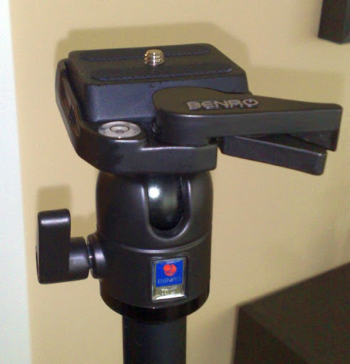

Posts: 10
Benro A-169M8 Travel Angel
Requirements:
Looking for a tripod that I could travel with but still sturdy enough, not over $200, and of decent quality so it lasts. After hours upon hours of research, I narrowed it down to the Benro A-169M8 Travel Angel line or the Velbon Ultra Luxi. Both appeared to be high quality and very compact. I chose the Benro simply because it came with free express (took 3-days) shipping from Hong Kong to Vancouver and I wanted to make sure I had it with me for my upcoming vacation!
The short list of desired features:
• Maximum height enough for 6'1” person.
• A good minimum height for low level macro.
• Sturdy enough. able to support at least 8 lbs of camera/lens
• Lightweight
• Compact. Able to fit in a carry-on sized suit case.
• Adjustable-angle legs
• Provision for spiked or rubber feet
• Relatively inexpensive

Benro A-169M8 w/BH-0 ball head
Youtube Video
Specifications:
• Sections: 5
• Material: Aluminum alloy
• Maximum height: 59.6 in (1515 mm)
• Normal height: 51.3 in (1304 mm)
• Minimum height: 13.9 in (353 mm)
• Weight: 3.3 lbs (1.5 kg)
• Folded length: 14.9 in (378 mm)
• Capacity: 8.8 lbs (4 kg)
Features:
• The tripod legs can be inverted and folded back 180° making it small enough to carry just about anywhere
• Reversible center column
• Center-Column Hook
• Optional Stainless Steel Spike or Rubber Feet
• Adjustable Leg Angle Stops
• Patented Dust & Water Resistant Rubber Lock Grips
• Built-in bubble level
Included accessories:
• BH-0 Ball head
• Nice padded/zippered case with shoulder strap
• Wrench
Price (August 2009, ebay): $190 USD (express shipping included)
Build:
Build quality appears to be very good. It has a solid feel and the moisture/dust resistant joints are nicely rubberized and definitely help the tripod feel extra sturdy.
The BH-0 ball head and quick plate are all metal and also feel solid.
The included bag, strap, and tool kit appear to be of high quality. The entire bag is padded as well as the handle. Inside there is a zippered pocket as well.
In Use:
The 5 section legs appear to be very sturdy. The largest legs are 25mm in diameter and the smallest are still 13mm so they’re not as small as some of the other tripods I researched that even went under 10mms.
The legs have two locked positions. Regular and then a low angle setting.
Extension and retraction of the legs is quick and easy with the rubberized twist rings.
The BH-0 ball head is made of all metal and has a pan swivel. It also locks and holds positions very well with my K100D Super and Tamron 17-50mm F2.8 lens.
The quick release BH-0 top plate is ~2” wide and all metal. The quick release has a trigger/switch safety to ensure you can’t just bump the regular lever and release your whole camera set up.
I cannot emphasize enough that the ability of this tripod, including the BH-0 ball head, into smaller than 15” is an amazing quality for anyone who needs to do air travel! It appears to be a very rare quality in most tripods on the market as I was only able to find a select few that could get under that size with the ball-head attached.
Summary:
Pro:
• No issues with sturdiness
• Good value for people on a budget but still wanting a decent tripod that should last
• High quality for the price.
• Extremely flexible with a reversible centre column, and 2 leg positions.
• Light and compact for the level of stability provided
• Extremely compact folding up with the ball head under 15”
Con:
• Flipping column is cumbersome (only necessary if you need to get under the min. height of 14”)
• No foam/grip cushioning on any of the legs
• The rubberized twisting
Similar competing products:
• Velbon Ultra LUXi-L
Photos
Comparison between the Manfrotto 055PRO and the Benro.
