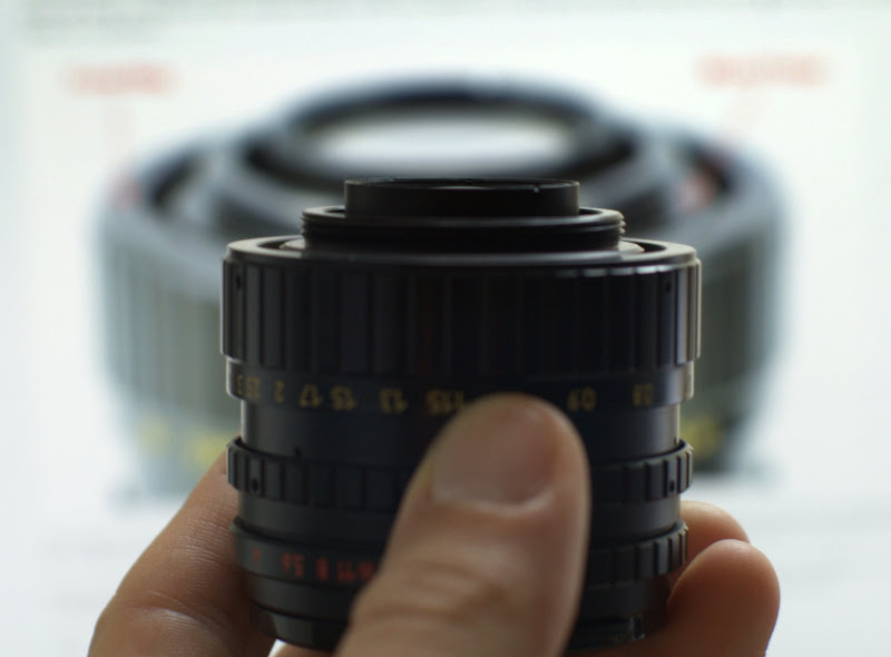

The Helios 44-3 was originally designed as the normal lens to be shipped with various Zenit 35mm SLR cameras. These bodies have a M42 lens mount with an unusually narrow body flange to accommodate the focus ring on the Helios 44-3. Now you are scratching your heads and muttering "huh?"...let me explain further. The focus ring on a pre-set lens is nearest the camera body with the aperture ring being towards the far end of the lens. On some models of the 44-3, the focus ring nests OVER the lens mount. Here is a picture:
The above lens was made in 1986. With most non-Zenit M42 bodies as well as all K-mount cameras (adapted), the focus ring will not clear the mount face on the body to allow for a clean mount. The fix is to machine the back of the focus ring down a couple of millimeters so that it is forward of the mount flange.
Note that this is not true of all Helios 44-3 lenses. The physical design varied over the years. So...before you contract to buy from a Russian or Eastern European seller where a return might be difficult, be sure to request a detailed photograph of the lens mount from the side.
Edit: Apparently date of manufacture is not a reliable indication of whether a lens has the incompatible design. At least one example made in 1994 has the issue (reported by lens owner on the Flickr Helios 44 group).

Interesting Steve, and of course you made me check my 44-3:
I remember that it worked OK with the M42 adapter on the K100D. That flange on the 44-3 that you have posted presents a challenge for grinding.
Same with M42 Mamiya Sekor SX lenses, and in a similar fashion all post-AI-lenses from Nikon (cause otherwise these are most usable on Pentax
K-mount without any adapter) - still thinking about grinding the outer bayonet of the cam - not by much and it would be SX and AI compatible :-)
My 44-3 must be a 1990 version, as you can see by the serial number 90xxx. The logo is Belomo, just like Steve said.

It's too late for me. I bought a 44-3 of 1986. Not infinite focus, but usuable.
ONLY 1986 lenses have the problem ( like we know N° 86.....).
Rino.
Rino.
Thanks for the info on the affected year. I will update the original post...

I just did a look at the current eBay auctions and there is a 44-3, serial #8403347 that has the problematic mount. Apparently the problem existed before 1986 as well.
Steve
