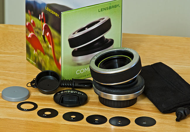

The package includes the lens, lens cap, 7 aperture disks, a tool for exchanging the disks (the tool also holds the disks not in use), carrying pouch, and a very brief user manual.

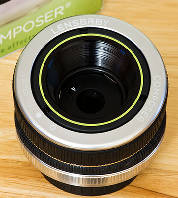

The lens is manual focus and comes in a simplified Pentax K mount without a stop down lever. There is no variable aperture so a stop down lever would serve no purpose. The aperture is changed by manually exchanging a black disk with a circular hole in it. This aperture disk is placed in front of the optics but is nevertheless somewhat cumbersome to exchange and the disks appear to be quite fragile. Aperture disks are included from f/2.8 to f/22 in full stops. Without a disk inserted the lens f/stop is 2. Naturally, the image in the viewfinder becomes quite dark and focusing difficult when a disk with a small aperture like f/16 or f/22 is inserted. Exposure is most conveniently done with the camera in Av mode. M mode can also be used. In this mode pressing the Green Button will set the shutter speed to match the f/stop of the lens.

The front element sits deeply and no lens hood is required as illustrated in the photo below. The photo also shows the aperture disk, here f/4, placed in front of the optical elements.

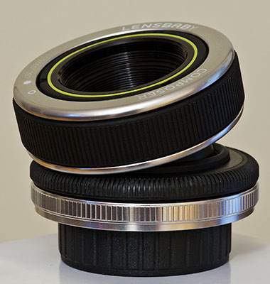

The lens has an amply sized, ribbed focusing ring which you also grab hold of to tilt the lens. There is no focus scale and there are no scales indicating the amount and direction of tilt (the lens tilts freely in all directions). You have to evaluate the effect in the viewfinder or on the screen and adjust the tilt and aperture until you get the effect you want. The lens is very light and the lens barrel is part plastic, part metal. The lens mount is of metal.
