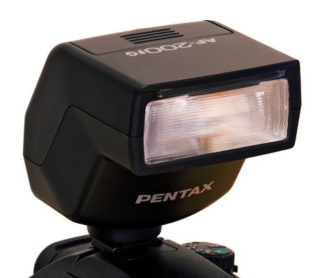

The PENTAX AF200FG flash is reasonably priced, compact and refreshingly simple to use. It is primarily intended as a shoe mounted replacement for the built-in flash but can be used off-camera if wired to the camera hot shoe. It supports P-TTL as well as TTL flash, and can be used with digital and film cameras.

The flash is compact and light and camera with flash balances well in the hand; we tried it with a K10D and a K-5. With its fixed flash head this flash is primarily intended for on-camera use as a replacement for the built-in flash. The flash can be used off camera, wired, but the required 5P synch cord and hot-shoe adapters are somewhat expensive. The flash does not support wireless operation.

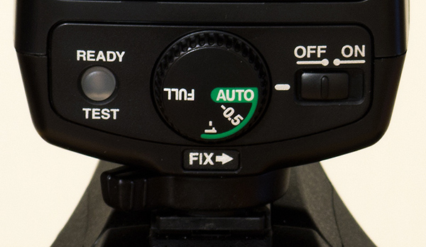

The flash is refreshingly simple to use with only four controls:
  • 1 - a lever to lock the flash securely in the hot-shoe
  • 2 - on/off switch
  • 3 - test button which lights up when the flash is charged, and fires a test flash
  • 4 - mode dial
The flash has two modes which are selected on the mode dial: AUTO and FULL (Manual). In AUTO mode one can optionally dial in -0.5 and -1 EV flash exposure compensation. If you also dial in flash exposure compensation on the camera, the two adjustments will be combined. In FULL mode the flash fires at full power and you must calculate and set the appropriate f/stop manually.

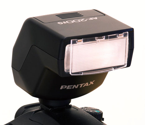

The flash has a built-in diffuser/wide-angle panel. With the diffuser pulled out the flash coverage increases from covering the field of view of a 19mm lens to that of a 16mm lens in the APS-C format. On a 24x36mm camera the coverage increases from a 28mm lens to a 24 mm lens. Nothing is free, of course - the guide number and hence range decreases by 25% when the diffuser is in use.

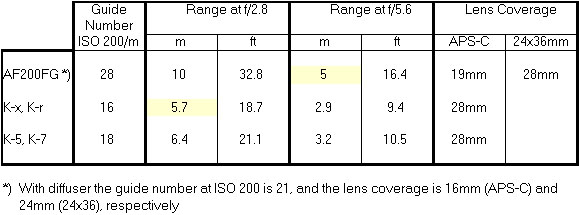

The guide number is 20 at ISO 100 and 28 at ISO 200. As highlighted in the following table, the AF200FG provides almost two extra stops of light compared to the built-in flash of the K-x/K-r cameras.
The guide number does not vary with the focal length since the flash head doesn't have a zoom feature. This of course means that light gets wasted at longer focal lengths since the angle of coverage then is wider than the angle of view of the lens. Had it been a zoom flash it would have had a longer reach with longer lenses. On the other hand, a flash with a fixed guide number is much easier to use in manual flash mode since there is one less thing to take into account when calculating the proper f/stop for a given distance. At ISO 200 we simply have the following formula with the distance in meters: f-stop = 28 / distance.

If you want an easy to use external flash primarily for on-camera use and with more power than the built-in flash, this unit may be for you. If we take the K-x as an example: The built-in flash at ISO 200 and f/5.6 has a reach of just 2.9 meters (9.4 ft), whereas the AF200FG has a reach of 5 meters (16.4 ft), or, put differently, with the AF200FG you get about the same reach at f/5.6 as would require an f/2.8 lens with the built-in flash. If you want to use the flash off-camera a lot you might be better off with a unit that supports wireless flash photography. Also, if you need a flash that emits an autofocus assist light the AF200FG is not for you.
