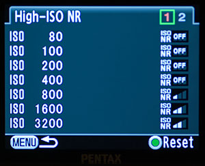

Now, let us take a look at how the in-camera High ISO Noise Reduction system works. The K-5 features a setting which allows you to control the degree of noise reduction (Low, Medium, or High) for each ISO setting, as well as completely disable it. You can also leave the setting on "Auto" and let the camera choose what it thinks is best. In our tests of this system, we took a photo for each of these settings (except for "Medium") at all full-stop ISOs between 80 and 51200 (inclusive).

According to these results, it looks like when the High ISO Noise Reduction option is set to "Auto", the camera typically disables Noise Reduction for ISO 80, 100, and 200, and chooses between "Low" and "Medium" for ISOs above that. It does not seem to ever apply the "High" setting on its own, likely because this setting results in loss of detail. Thus, we can recommend the "Auto" setting for the typical JPEG shooter, as seems to pick the optimal NR setting for each scenario. More advanced users may want to shoot in RAW and use a noise-reduction program when post processing to handle the noise instead: this should yield the same, if not better results, but will be more time-consuming than using the in-camera option. Since the K-5 does a great job of handling noise in general, the loss of detail due to in-camera NR may not be an issue for most users. Another important thing to note is that if you're using Noise Reduction, there's a huge drop in image quality from ISO 12800 to ISO 25600 (as you enter the expanded ISO area). Thus, ISOs above 12800 shouldn't be used when you're looking to preserve details in your images. This can more clearly be seen in the "Sample photos" section of our review, but it's also visible in the test above.
The NR system seems to be particularly effective at the "Low" setting, as it reduces color noise and grain without significantly degrading sharpness. We think it'll be best if you see these results for yourself, so feel free to browse through the test photos to see how the NR system works for all the different ISOs and intensities! We feel that the results will positively surprise you, so we'll let the images do the talking! Keep in mind that in that menu, you can always selectively choose at which ISOs the camera performs Noise Reduction.
