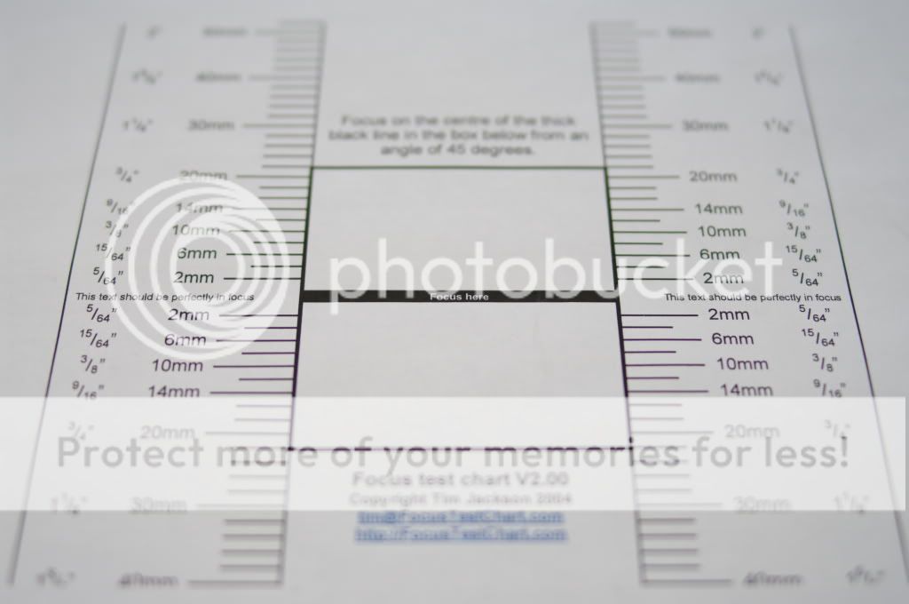

Good day, i have run some test on my FA31 and it seems to be a little soft. Using the focus test chart, I took several shots at different f stops to see the difference in DOF. Camera is a K20, ISO 100, "natural" setting with no adjustments, AV setting to adjust the f stop. The camera was mounted on a tripod and the shutter delay was used.
This is my shot at f1.8:
It appears quite soft and a considerable amount of purple and green fringing.

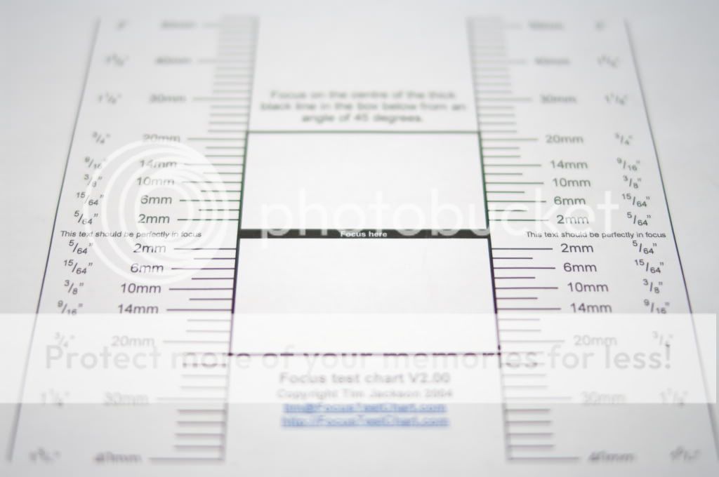

At F2.8:
Although it is a tad sharper, there is still some purple and green visible.

Looks basically correct to me...

QuoteOriginally posted by Waldo Humblebee Quote
This will happen since the lens is not apochromatic. In fact I'm not sure any Pentax prime is.

Fringing outside the plane of focus is normal. The lens is corrected for the focus plane.

The purple and green tint in the OOF areas is perfectly normal.
I believe what you are perceiving as lack of sharpness at f 1.8 is actually lack of contrast as compared to smaller apertures.
Nothing in your f1.8 pic looks abnormal to me.

Thanks for moving and the replies. I had a chance to take it out today an I am very pleased. It's not too soft at all, even at f1.8.
