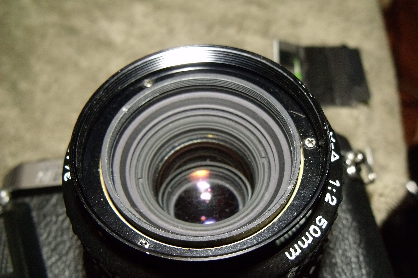

So today I decided I wanted to try to tackle cleaning the fungus out of a 50mm prime, I took it apart enough to be able to remove the front element group, But realized I'm going to need an adjustable spanner to remove the retaining ring on there before I can get inside so I put it back together again.
Does anyone have any experience in cleaning a lens like this that could provide advice on how to clean the fungus properly, and the best way of getting inside those two elements?
Here's some pictures of what i'm dealing with.
Taken apart
What I need to open up.
Nastiness.
07-21-2010, 06:31 PM   #2

Hell, I managed to get the locking ring of the outer element open, and saw some strange pattern of fungus on the inside, it looked like the veins of a person's eye, but it cleaned nicely with vodka and windex (best stuff I had on hand) and I also managed to get the rest of the element groups out of the "tube?" but i'm gonna have to get that spanner soon so I can open up the groups to clean the insides.
Front locking ring removed
Front element, liberated
lens with front element removed
here is lens with front element removed and the center group in my hands, Look at that nastiness.
NOW we go through the backdoor
that's the rear group removed,
