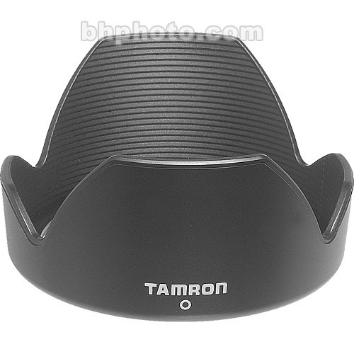

01-30-2008, 12:59 AM   #1
Join Date: Oct 2007
Posts: 128
Comments on the SMC Pentax-FA 28-105mm F4-5.6 [IF]?
Here is the lens I'm talking about:
SMC Pentax-FA 28-105mm F4-5.6 [IF]
There aren't any reviews on this lens in the database, and there's relatively nothing much about it on the internet... so I took a chance and tried if maybe there were a number of photographers here who have something to say about this lens?
If I'm buying it second-hand, what would you think would be a good price to get it for? What about brand new?
Thanks!
01-30-2008, 08:03 AM   #2
Join Date: Oct 2007
Posts: 128
none? anyone? It's being offered for around $100, second-hand. Thanks!
01-30-2008, 08:06 AM   #3
Gooshin's Avatar
Location: Toronto, the one in Canada.
Posts: 5,611
if it fits your focal range go ahead and take it, i had a similar piece only it had the powerzoom thing on it, it was my first lens, and my first lens to hit the floor and break
i dont really miss it....
01-30-2008, 09:00 AM   #4
Lowell Goudge's Avatar
Posts: 15,400
QuoteOriginally posted by Gooshin Quote
if it fits your focal range go ahead and take it, i had a similar piece only it had the powerzoom thing on it, it was my first lens, and my first lens to hit the floor and break
i dont really miss it....
Note the power zoom lens was completely different optically, and was not internally focused.
I have both the 28-80 and 28-105 power zooms. optically good, but the front group, which both turns for focus and extends for zoom never really felt solid, there was a lot of side to side play in the group. Used them quite a bit until I got my tamron 28-75 f2.8
01-30-2008, 09:08 AM   #5
FotoPete's Avatar
Posts: 1,710
Its only of those tamrom zooms that got rebadged. It shouldn't be too bad. Tamron's made pretty good lenses in the past.
Its just that this lens won't be providing all that interesting a focal length @ the equivalent view of a 42mm-158mm lens.
01-30-2008, 04:35 PM   #6
Join Date: Oct 2007
Posts: 128
@FotoPete: What do you mean "this lens won't be providing all that interesting a focal length"? What would you say would be an interesting focal length?
So basically, this lens i'm asking about is okay. At the most, it's good but nothing exceptional?
For $100, a used (in good condition) piece would be a good buy?
01-31-2008, 06:04 PM   #7
Location: Houston
Posts: 46
I have a similar Pentax lens (J series 28-105). This is a great focal length range.
1) Christmas, inside a normal size house: wide enough to show several kids openning presents, long enough to zoom in on a face.
2) From a car: wide enough for road side scenes and landscape.
You will like this lens.
01-31-2008, 06:42 PM   #8
Duh_Vinci's Avatar
Location: Virginia, USA
Posts: 1,286
Yes, I think $100 for a used in good condition as a good price. That lens in the photo in the database is the actual picture of my lens (was mine), I sold it few months ago... I sold it for $180 shipped on ebay (probably because it was all black, never seen one all black, only silver model), lens was flawless...
It was nice walkaround lens, sharp from moderate to good light, very contrasty, fast AF (fastest of any AF lenses from Pentax I've tried - small turning radius)... I tried to post review, the section database did not open up the place to type in the text??? Some lens creep (typical to Tamron built lenses). Manual focus ring was very useful imo.
Hope this helps...
Regards,
D
02-07-2008, 08:34 AM   #9
knyghtfall's Avatar
Location: Singapore
Posts: 348
Pentax 28 - 105 /3.2 - 4.5
Just curious, I own the other version of this lens: the FA 28-105/3.2 - 4.5. How is this one different from the 4 - 5.6, optically? is the 3.2-4.5 also a rebadged Tamron as well, or its an altogether different lens from the above?
02-07-2008, 07:00 PM   #10
creampuff's Avatar
Location: Singapore
Posts: 3,955
QuoteOriginally posted by FotoPete Quote
Its only of those tamrom zooms that got rebadged. It shouldn't be too bad. Tamron's made pretty good lenses in the past.
Where do you get the information that the lens is a re-badged Tamron?
To my understanding only the Pentax FA 28-200mm f/3.5-5.6 superzoom was attributed to be a Tamron design, though this was never publicly acknowledged by Pentax.
lastdodobird, for this focal length, there were 2 different lenses from Pentax, the faster f3.2 version and the more common f/4 version. The former gets the better reviews while the f/4 version is an average performer. Please note that there were several iterations of the f/4 version.
02-07-2008, 09:24 PM   #11
Duh_Vinci's Avatar
Location: Virginia, USA
Posts: 1,286
QuoteOriginally posted by creampuff Quote
Where do you get the information that the lens is a re-badged Tamron?
To my understanding only the Pentax FA 28-200mm f/3.5-5.6 superzoom was attributed to be a Tamron design, though this was never publicly acknowledged by Pentax...
I can assure you, it was, the only difference between "Tamron" badged lenses, Pentax added their own zoom grip, typical to most of their current zoom lenses. Otherwise, 100% Tamron down to the pinch-style front cover (full specs of tamron here: http://www.tamron.com/assets/pdfs/179D.pdf and my old Pentax lens https://www.pentaxforums.com/lensreviews/data/44/large/SMC_Pentax-FA_28-105mm_F4-56.jpg, and the hood to Tamron since it is not in the manual picture http://www.bhphotovideo.com/images/largeimages/169282.jpg)
Regards,
D
02-08-2008, 01:18 AM   #12
Asahiflex's Avatar
Location: Netherlands
Posts: 2,754
I do not know the FA 28-105 [IF], but the older SMC Pentax-F 35-105mm should at least be as good. The only downside is that it is somewhat rare and that it is lacking on the wide end, and it is a little heavy too (lots of metal). To me, it is plenty sharp. I already like it a lot!
There is no apparent PF or CA that I can see. Some test photos (not altered in any way, just resized):
1. Macro
2. Macro II
3. 35mm setting (2s)
4. Bokeh test
02-08-2008, 02:28 AM   #13
joele's Avatar
Posts: 1,309
QuoteOriginally posted by knyghtfall Quote
Just curious, I own the other version of this lens: the FA 28-105/3.2 - 4.5. How is this one different from the 4 - 5.6, optically? is the 3.2-4.5 also a rebadged Tamron as well, or its an altogether different lens from the above?
There are 3 versions..
4-5.6 powerzoom, 3.2-4.5 and the tamron rebadge 4-5.6..
I have owned the 3.2-4.5 and the powerzoom.. Both are made by pentax (not rebadge) and both are pretty good for what they are.. The powerzoom was slightly better at the wide end and the 3.2-4.5 quite a bit better at the long end.. Also the 3.2-4.5 is much lighter..
The tamron rebadge is still OK but apparently behind the other two..
02-08-2008, 07:37 AM   #14
Location: Canada
Posts: 828
I own the F35-105 but I admit I almost never use it. Maybe I should exercise it a bit more!
02-10-2008, 03:33 PM   #15
Join Date: Feb 2008
Location: britain
Posts: 4
tamron 28-105
I bought the Tamron version of this lens a few weeks ago second hand for 74.00, I am very impresssed with its performance so far it is very sharp and does not seem to suffer from any CA as yet and a really great portrait lens to boot, money well spent I think. The only issue so far is its a tad slow but at that price its a compromize.
28-105mm, f4-5.6, k-mount, lens, pentax lens, pentax-fa, slr lens, smc, smc pentax-fa 28-105mm
SMC Pentax 105mm F2.8 and SMC Pentax 50mm F4 Macro Adam Pentax SLR Lens Discussion 3 05-15-2010 10:57 PM
SMC Pentax-A 35-105mm f/3.5 clarkebd Pentax SLR Lens Discussion 18 04-11-2010 04:58 AM
Any comments on SMC Pentax FA 28-200mm AL(IF) lens? cb750r Pentax SLR Lens Discussion 1 09-15-2009 06:45 PM
All times are GMT -7. The time now is 05:07 AM. | See also: NikonForums.com, CanonForums.com part of our network of photo forums!
