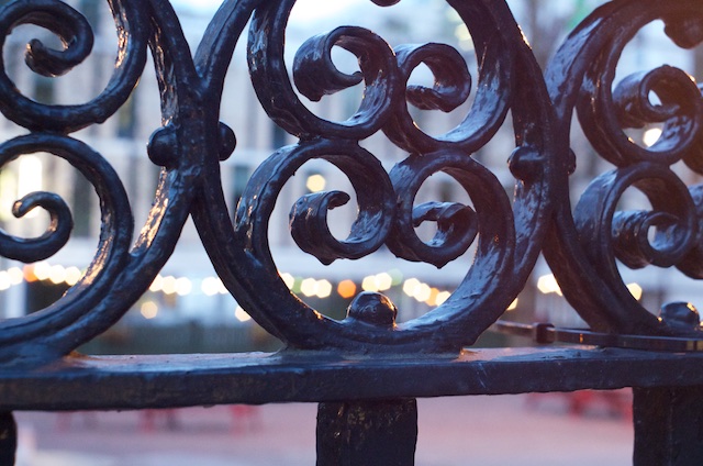

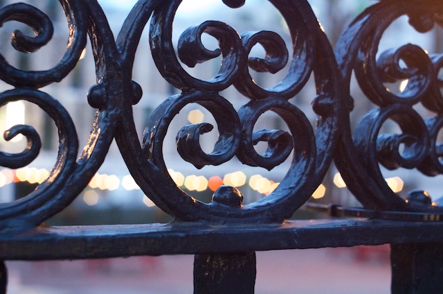

A cheap lens, although not in K-Mount, are the later (black) Carl Zeiss Jena Tessar 50mm 2.8. They can be had for a song, and a third party M42 adapter is cheap, too.
You can see for yourself, here are some photos taken with the lens from wide open to stopped down:
