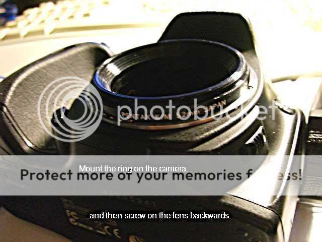

Attaching close up filters means adding more pieces of glass on the lens which will lower image quality. I would assume +6 to be a fairly strong filter so you may get some distortion too.
I use reverse macro rings. They are very cheap going for like $5-10 on ebay. They have a screw thread on one side and a K Mount on the other and lets you mount the lens on backwards. This gives you about the same effect as a macro lens would. However you must focus by usually moving the camera closer to or farther away from your subject for it to focus. Some lens designs may enable you to actually focus using the focus ring although its a bit hard as you tend you unscrew the lens.
Another tip. I cannot explain why but reversing lenses of wider focal lengths yields more magnification. The reverse lens technique only seems to work up to len focal lengths of around 70-80mm. Anything longer doesn't seem to focus.
And using FAJ/DA lenses are rather hard because the aperture assume f22 or f32 position as there is no way to open the lens up without an aperture ring. (other than to carefully push the pin on the back. you can easily touch the rear element like this.)
Here's what the setup would look like. Note, I used the 18-55mm for this one. Its generally not recommended and primes with aperture rings are much better suiting for this task.
Make sure you buy the right macro ring size for your lenses. If you have alot of 49mm filter thread lenses, get a 49mm. I have both a 49mm macro ring and a 52mm one.

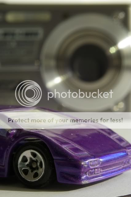

Here's an photo I took with a reversed M 50mm f/2.0.

here's another example of the reverse mounted lens.
somewhat tricky to use....
