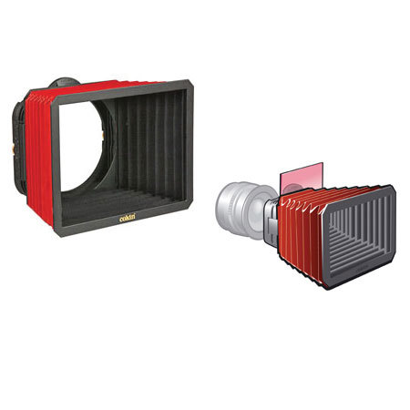

QuoteOriginally posted by wwwmorrell Quote
Buy yourself a 82mm polarizer plus a 82mm/77mm Step down Filter Ring, one size fits both.
10-03-2009, 10:08 PM   #14
wwwmorrell's Avatar
Location: Mount Buller, Australia
Posts: 398
knumbnutz;763540]Whoa !!
Is there such a thing ?
Sure is
10-03-2009, 11:39 PM   #15
Join Date: Nov 2007
Posts: 1,553
QuoteOriginally posted by knumbnutz Quote
Whoa !!
Sure is
If you buy a Cokin holder you can use their or Lee's hood system.
If you are buying for a Pentax digital, and the 82mm lens in question is a 135 format lens, I would go the other way on the rings, 82 to 77mm step down and a 77mm CPL. You then wouldn't have any issues with the lens hoods.
I'm using a 86 to 77mm step down ring on the Sigma 170-500mm on the K20D so that I can use my 77mm accessories.
