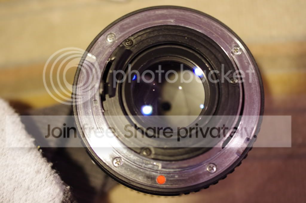

Here's a pic of the lens in question:
P.S.: I've checked the AF/MF switch (it's on AF)

The lens is the issue - like M42 lenses, that K-Mount lens has a coating (paint, powder coating, some kind of finish ) on the bottom of it.
Most old K-Mount manual lenses do not have a coating and the lens flange/base is bare metal and thus acts as a conductor. When the lens is mounted on the camera, the pins/contacts on the body automatically short out - with the coating, the flange on the lens does not act as a conductor and thus does not short the pins/contacts automatically (this will also be the case with cheaper built lenses that do not use metal flanges/bases).
Search the forum and there will be detailed instructions that will show you how to foils the pins/contacts...
