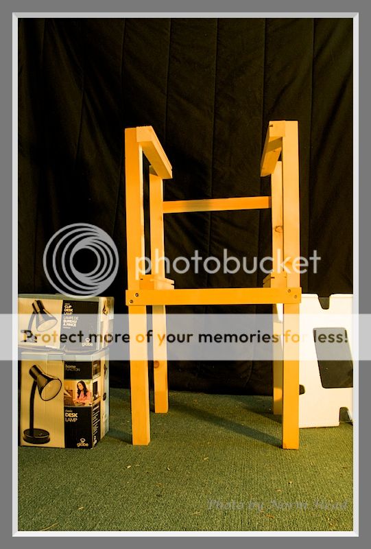

Here is the basic frame
Notice the slots in the rails at the top and mid points. They are designed to accept the glass from an 11x14 2 dollar picture frame we picked ap a long time ago at the dollar store. Those will provide transparent table surfaces.

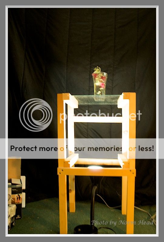

Glass inserted in the top, here is the first set up, one light shining up from the bottom.
Here is the resulting photo of the above set up.

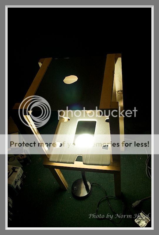

What's wrong with this picture? The glass pane is distracting, the light isn't at all focused, we aren't getting everything we could from the set. The next thing I did was to add a black mask to the glass to stop light not coming through the bottom of the glass from hitting the glass. ( All you young guys thought a mask was something Photoshop invented didn't you?)
Here's the associated picture.
