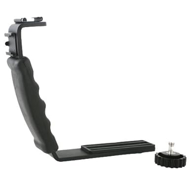

I've wanted to use a bracket for off-camera flash for a while now. I currently have a K-30, Metz 50 Flash, Cactus V5 flash triggers, and this flash bracket:
Amazon.com: Heavy Duty Photography L Bracket with 2 Standard Flash Hot Shoe Mounts: Camera & Photo
I know that I can use the radio triggers and the flash in manual mode, but is there any way to keep P-TTL functionality while it's mounted on the bracket? I know that there are hot shoe adapters out there, but I don't know if they're used to keep P-TTL or even TTL. Can I use my current triggers? Thanks.

not sure with your flash, but with the Pentax AF540 FGZ (and previously with the AF500FTZ) there is a cable extension of the hot shoe (Off-Camera Shoe Adaptor F), that plugs into the flash to allow off camera but still wired to the flash.

You cannot use your radio triggers; that is, they won't magically become P-TTL capable because of the bracket.
You need these little (expensive) buggers:
- F5P (short), or maybe F5P (long);
- Hot shoe adapter FG, or maybe hot shoe adapter FG; and
- Off camera shoe adapter F
I seem to recall seeing some generic integrated cables with adapter ends on Adorama.

Yeah, I wasn't thinking the bracket had magical powers or anything. I just didn't know if connecting the triggers with a cable, instead of using them wirelessly, could allow some sort of ttl or pttl capability. I'm assuming that won't work.
I did see that Aputure sells this product. Seems to be a knock off of the adapters that Pentax sells.
Amazon.com: Aputure Pro-Grade TTL Off-Camera Hot-Shoe Flash Sync Cable for Pentax Digital SLRs, Pentax *ist DS, DS2, D, DL, DL2, K10D, K20D, K100D, K110D, K200D, K100D Super, K-5, K-7, K-30, K-r, K-x, K-m, (K-m A.K.A. K2000), K-01 and Pentax AF 360 F

Sorry I misunderstood. I don't have any RF triggers, but my understanding from following the threads is that they are all manual, no P-TTL.
There is also the Aokatec triggers, but those kinda cheat because they don't actually do regular P-TTL. Rather, they just proxy the optical Wireless P-TTL signal over an RF connection. Normal P-TTL just fires one preflash, and then one main flash, through your hotshoe. Wireless P-TTL adds a bunch of signal flashes between the controller and remote in addition to the preflash and main flash -- and yes, with the Aokatec units, you do have to use your pop-up flash (or another hotshoe-mounted flash) as a controller.
Wireless P-TTL flash sequences are really fast, but I could almost swear that I can tell the difference between the time it takes to fire a Wireless P-TTL shot, vs. a normal P-TTL shot. Not sure if I am right, or if it is all in my head.

I have that same flash cord and it works perfectly fine in P-TTL mode.
