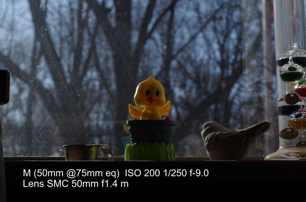

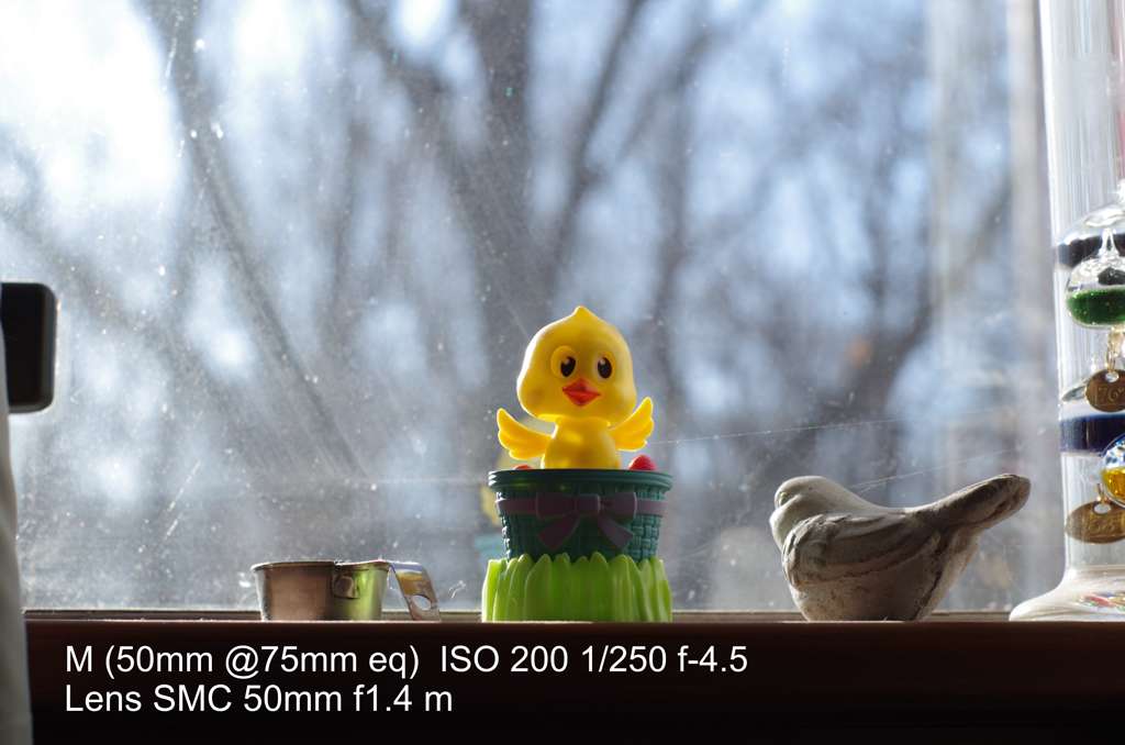

I picked up a k-30 from a charity auction site two days ago and last night I finally unboxed it.
This morning (when there was abundant light...) I started to fool around with it... The first thing I did was to reset all the settings and user options, format an SD card, then update the firmwear.
I also changed the "Aperture Ring" setting to enable, fitted an 18-55 DAL WR lens on it and took some pictures on auto...
They looked under exposed by an EV of -5 or Shutter speed double the correct exposure with lens stopped down to f22.
Now, I am still confused, because I've conducted the test from the beginning of this sticky thread, using an "F" lens with an "A" aperture, a Pentax "DAL" lens (setting the shutter speed and aperture in the camera) and a completely manual SMC lens (SMC 50mm 1.4) and the results are all over the place.
If I read the test instruction correctly... if I have the aperture block failure, the "A" lens will give me dark image in "A" mode, but near normal image with an aperture selected, (if all other settings are correct for the image.)
Then I did the same test with my manual 50mm... (I had no auto mode to compare)
Then I manually set up the camera with the crop sensor lens that is made for the K-30. (a DAL 18-55mm).
Here are the results (all images are marked with the lens and settings.
So, after looking at these images, my question is... am I dealing with the "aperture block failure" with this camera?
Correct exposure
Deliberately underexposed.
This is the settings the cameras computer told the camera to set the aperture, speed and ISO.
