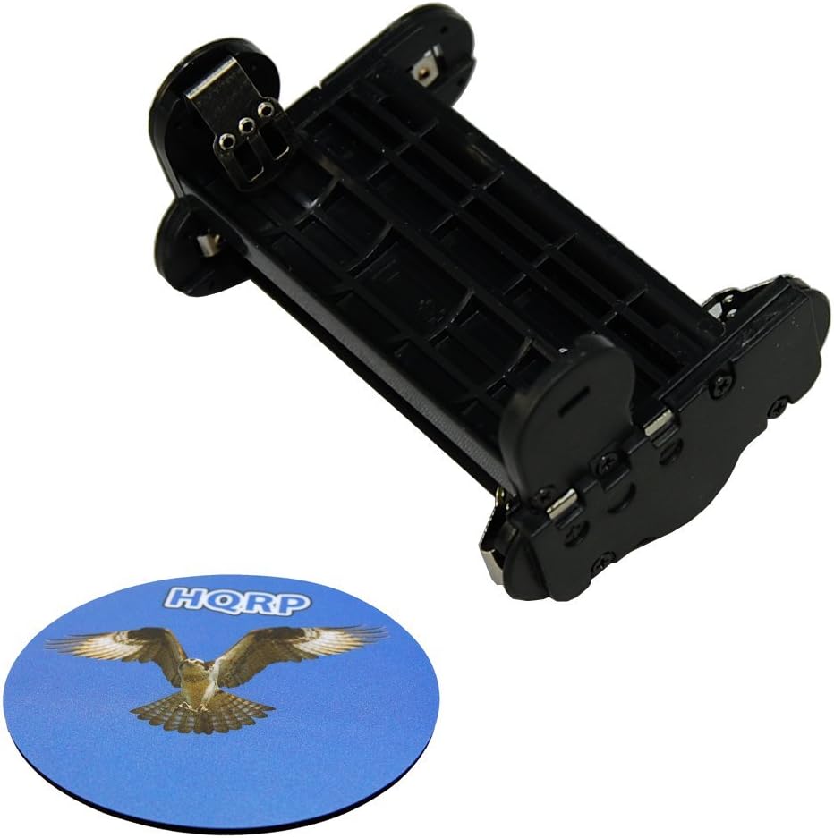

But you use batteries with the AA-Adapter. That is the same, because there is more current available:
Reread THIS earlier post of yours that might help.
I wrote to you that I do not use AA batteries, Eneloops (or any others). I am using the supplied D-LI109 battery.

when I use the adapter with batteries, the problem disappears
How I understood this was that your K30 develobed ABF and you then used the AA-adapter
which is with AA-batteries and the problem then disappeared.
That's how I understand your message but please correct me if I am wrong!
This approach is well known, it worked for many (at least a short time).
