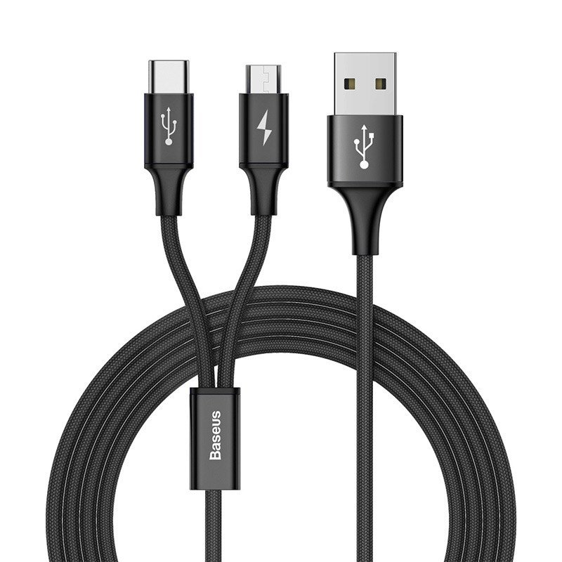

I have never seen a “split” cable - I didn’t even know there was such a thing.
There are "2 in 1", "3 in 1", even "4 in 1" phone charging cables, one USB-A male (usually) split into USB-C, micro USB and perhaps other connectors - the idea being that you'd use a single charger/port to charge several devices at once.
I'm thinking that if e.g. an USB-C device would negotiate a higher charging voltage (if not through Power Delivery, maybe through Quick Charge), the micro-USB device connected next to it might get fried. Anyway, it's not something I'm willing to try.
This is what I'm talking about; phoebus pointed out to another type of split cable.
My point is that this has nothing to do with those of us who use USB with a single unitary cable.
