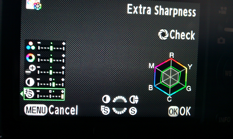

QuoteOriginally posted by Red Solo Cup Quote
There just doesn't appear to be a lot of bite and pop from the images, almost like the JPG engine is really knocking the sharpness down.
You do realize that if you are shooting .jpg, that the K3 for every color/profile comes with the sharpness in the middle range?
Go into the settings and change it to sharp or extra sharp.
Most folks who are concerned with sharpness shoot RAW and tidy things up in post.

QuoteOriginally posted by LaurenOE Quote
I realized this right after I posted this thread late last night. In my experience with other cameras with this type of adjustment capability, I was always weary of over-sharpening and was told on other forums that either the sharpness can be bumped up 1 notch, or not at all as it was not needed. After testing I found that to be true. With the K3, do you find that you need to bump it up 2 notches or more to get acceptable sharpness with JPGs?
I no longer shoot in .jpg so I don't really know, but I would say "EX sharpness" if I was shooting in .jpg now.
When I *did* shoot .jpgs pre-lightroom, that is what I did.
Since you are new to Pentax, you can't take what you did with *other* cameras and apply that to a Pentax.
We are different and Pentax doesn't really care too much what other makers do.
