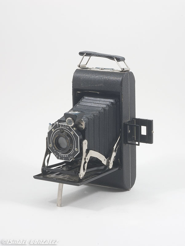

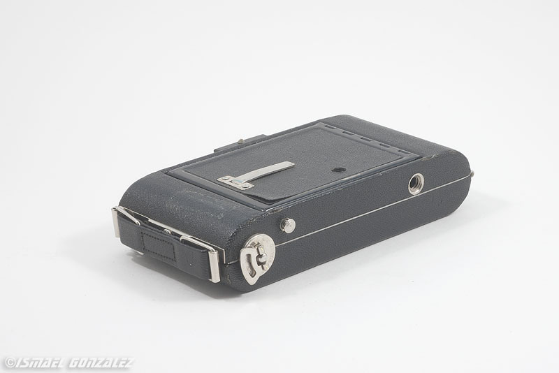

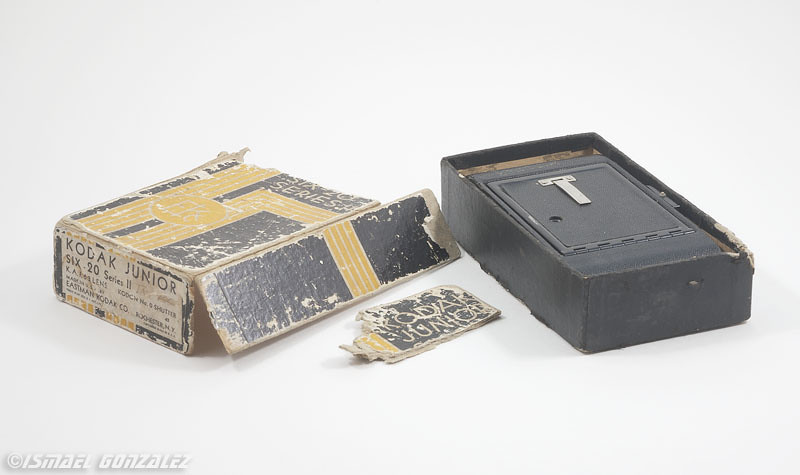

My specimen:
I got this many months ago but hadn't have a chance to work on it.
Looks complete. Hard to see in the pics but it is extremely dusty inside and out. Also very stiff.
This is the less common Series II with the f6.3 lens so that puts it around 1937 or early 1938.
I have been able to find only 3 other identical units online with legible serial numbers. Another mystery as two are five digits serials: 51xxx and 55xxx while another is six digits 105xxx like mine which is 106xxx
So I can't yet establish any relationships with serial numbers, other than mine is higher.

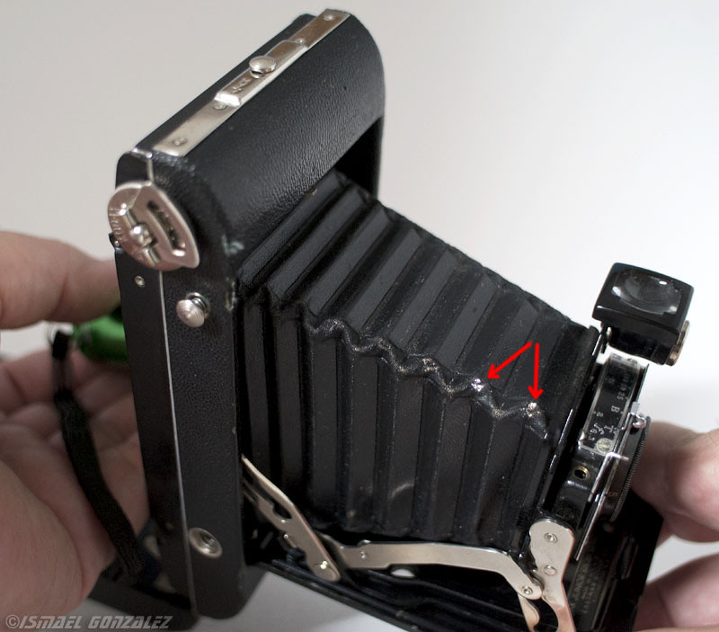

Hello,

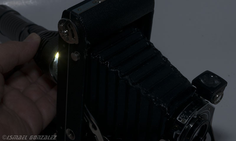

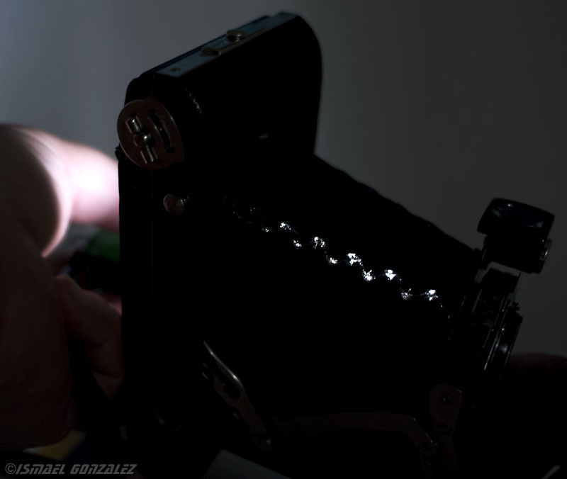

These 2 spots in the bellows are suspicious. I'm sure those are light leaks I need to address.
The best way to check is in dim light with a flashlight inside:
WOW! That's not a leak. That's incontinence!!!!
I'll dive into it as soon as I get a chance.

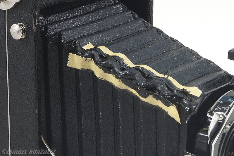

If you have doubts about liquid rubber been messy to work with, I'm here to tell you IT IS!
But it eventually cooperates. Now I know why it is so hard to find anybody to service old bellows. It has taken me over 2 weeks of a few minutes here and there every day and I'm not done yet. I think I've put a few hours into this bellows already and it was in rather good shape to start with!
But it is going the right direction. What you see on the ridges is actually reflections from the top, not light leaks.
That is a super / blinding strong / gazillion lumens / nuclear powered CREE camping torch light. One corner down, 3 to go.
Curious what the process is - can you seal from the inside or is it too hard to access?

QuoteOriginally posted by UncleVanya Quote
The inside is quite hard to access but it also seems to have a layer which is evidently not opaque. Feels like some sort of paper. I'll post a pic of it later.
