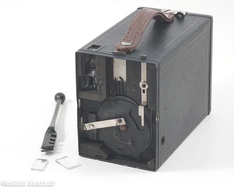

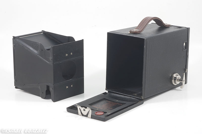

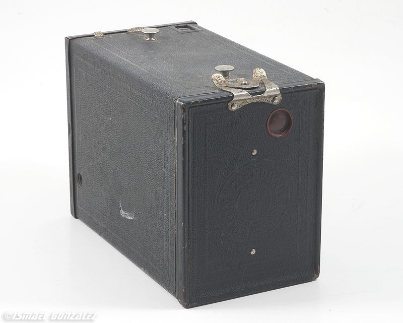

So I got this one: Missing the strap and dirty. First impression is that it looks to be in good shape otherwise.
I have research date this unit to between 1927 and early 1931. Last patent imprinted is from March 1927 and the winding key was replaced with a big round knob in early 1931. If patent information was updated regularly, then I guess it makes sense to put it more to the earlier rather than the later part of that time window. I'm looking online to see if I find similar units with different patent info that may help narrow it even more.

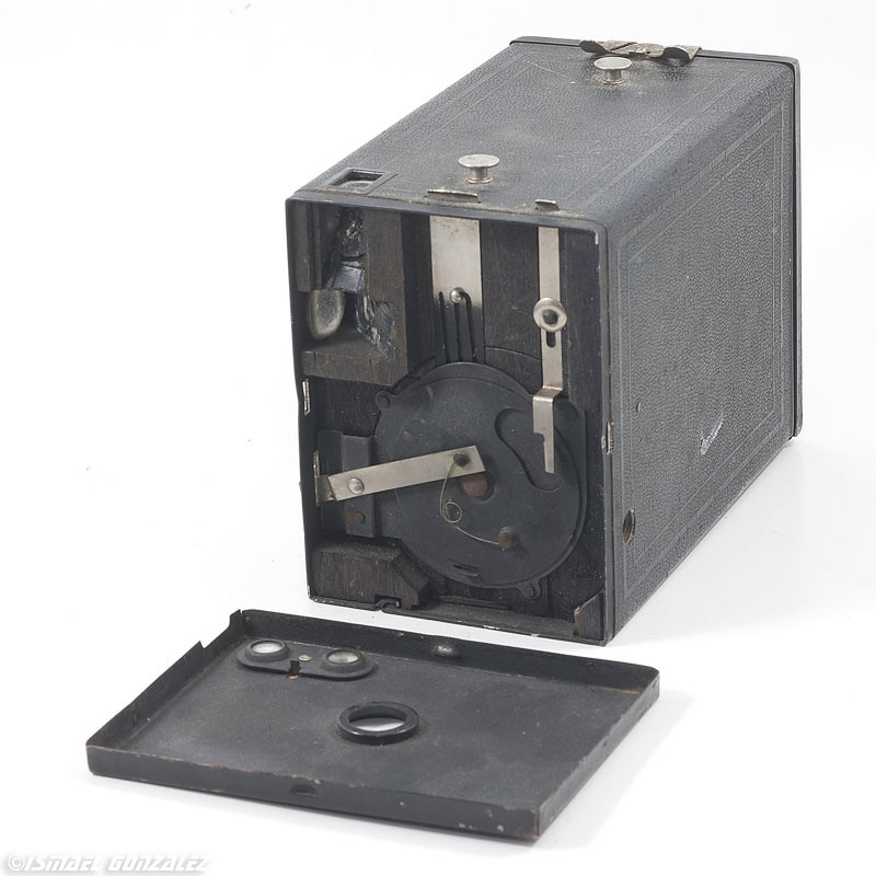

But wait, something is wrong: The front plate is upside down. The viewfinders lenses should obviously align with the viewfinders. DUH!

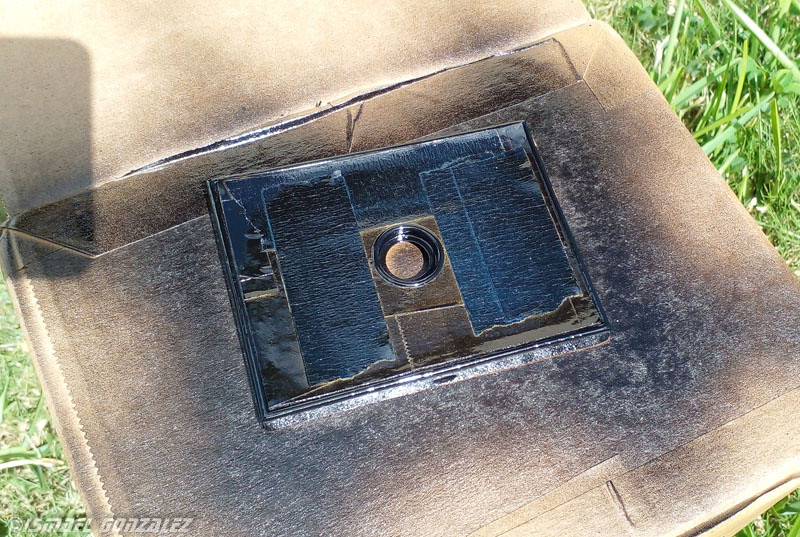

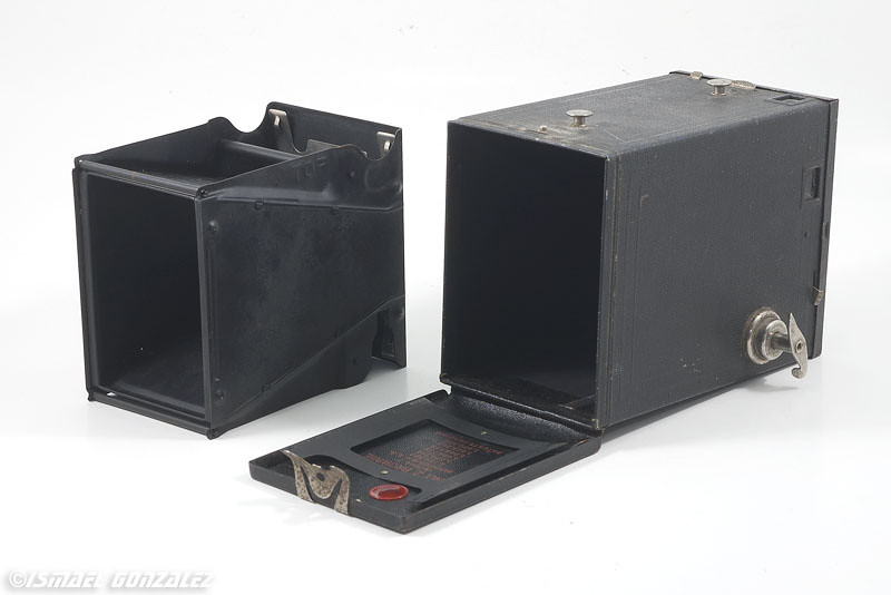

Other than very dusty, the film carrier is in great shape
But back to the front plate, is it just an innocent mistake or is it hiding something?
Sure enough, the mirrors are not there so the view finders are not complete.
Before we continue, the leatherette is very brittle and it seems to be "inferior" to the earlier models. So is the black paint on the metal surfaces. Also, the plating is not as good as earlier models. I guess by this time cost was becoming a bigger consideration as part of the business. Keep in mind these were at the low end of the spectrum.

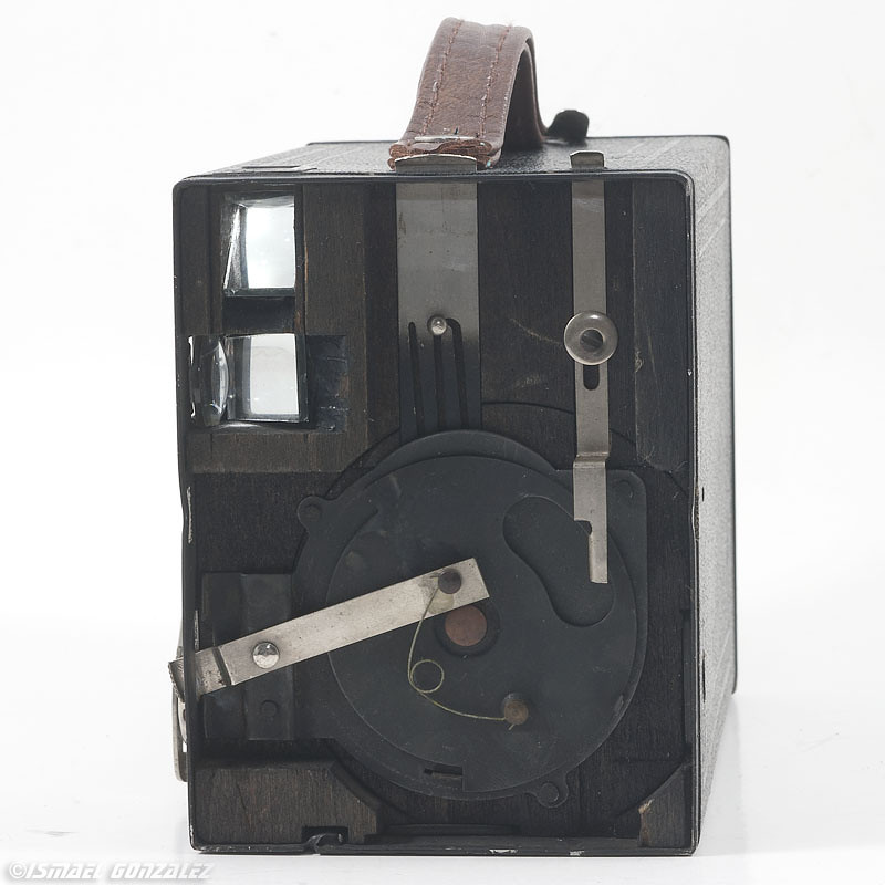

Hello again!
This was worked in the background in the past few weeks. Here is a summary.

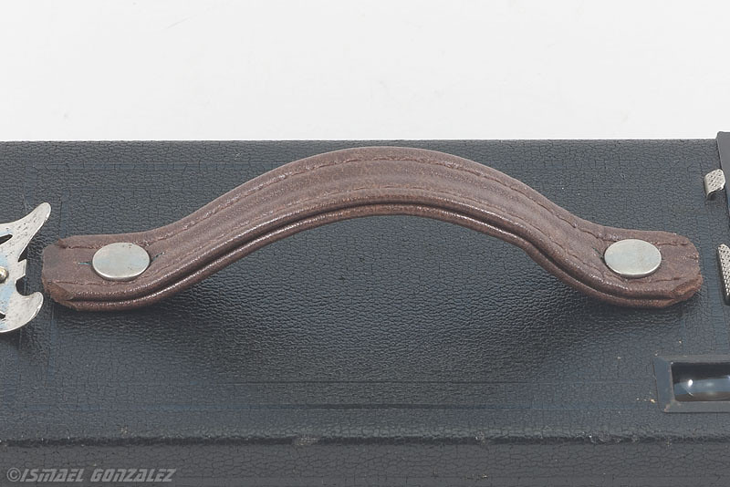

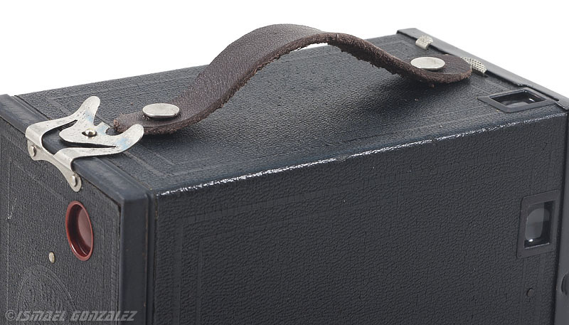

Remember I was fooling around with handle straps on the other camera? I did this one and it works good here.
No mirrors? No problem. We have cracked the code!
By the way, the shutter remains similar in operation but it is an updated design. It "feels" smoother than the earlier versions.

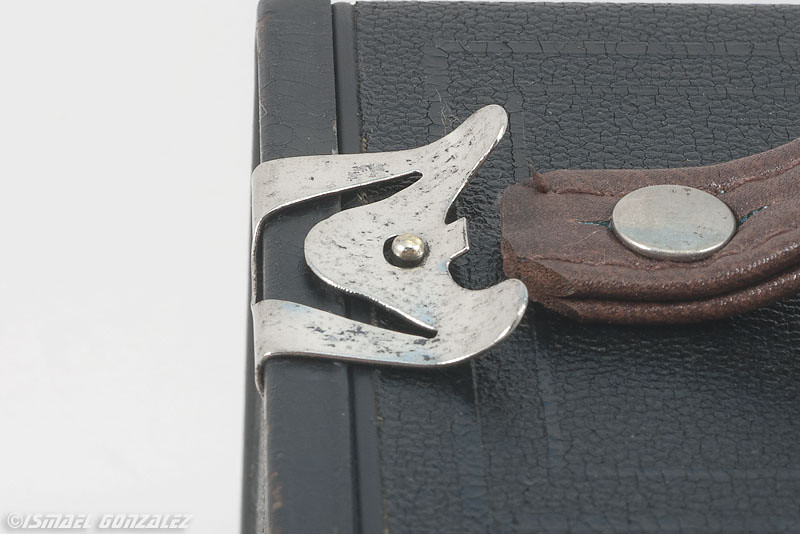

The plating is definitely different. Here you can see there while it cleaned nicely, it is pitted. No biggie and it gives it some patina. You can see the closeup of the cracked leatherette.
I'll leave it alone and will not even try to do any metal work or repaint or anything...

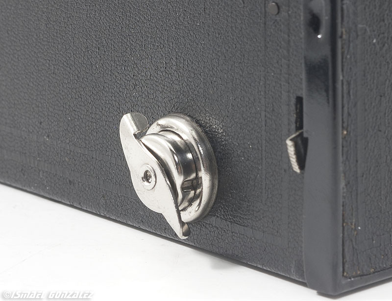

The winding key did polish out nicely
Coming up next, completion, reassembly and ready for testing!

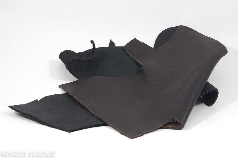

Hello,
Remember my friend the shoemaker? I stopped today on my way home and got 2 scrap pieces of leather. One black one chocolate brown.
This is real leather. Just like George Eastman would have requested.
I need to work on my leather working skills but I like this color.
As soon as I get a chance, I'll do a black one just to see how it looks.

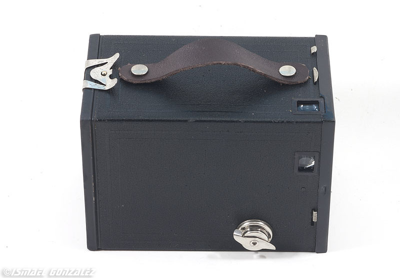

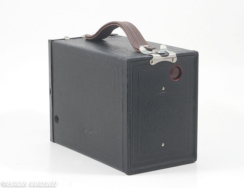

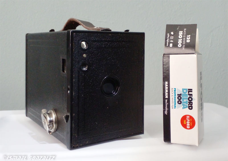

PRESENTING MY NEW KODAK BROWNIE No.2 MODEL F
Hello, This was more of a quick refresh job rather than a major restoration as it was in good working order.
This one is now ready to go out into the wild and mingle with the young!
Yes, I've made several straps and I like them all. They are interchangeable.
The roll holder was simply dusted off. It is in GREAT shape

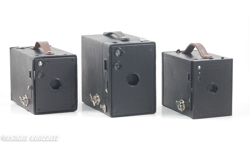

..and the money shot: Family picture
left to right:
No.2 Model D (~1916, full restoration still pending vintage screws to complete before releasing to the wild)
No.2A Model B (~1918, already shot a roll with it)
No.2 Model F (~1927, ready for the world)

The youngest of the Brownie sisters (age: ~94), was taken out for a workout today.
Keep in mind, users of this type of cameras back then did not look for golden hour light or looked out for best time of day for diffused light. These cameras were meant to be snapshooters for children or beginning amateurs. You were traveling and along the way you saw a waterfall. You stopped, snapped a pic and continue your journey. That simple. So I drove to my favorite waterfall about mid morning - close to noon, to better simulate a typical use back on the late 1920's (the truth is that was the only time I had to sneak out of the office ).
But it was almost dry! Very little water and it was pretty dark with heavy shadows.
Since this camera features tripod sockets, I think I saved the day by doing some long-ish exposures of 2 to 3 seconds plus a few "instantaneous" snaps. Can't wait to see the results.
