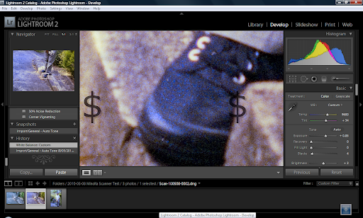

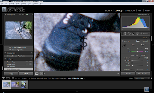

I just bought a Minolta Elite 5400 film scanner, and just scanned my first negatives using Vuescan Demo (hence the dollar signs).
Scanning the Konica VX100 SUPER negative using Vuescan with autofocus yielded a seemingly sharp image. However, a very heavy blue cast appears in the photo.
I selected the film type in the 'Colour' section in Vuescan, but the colour is still very blue to me. See below:
Above: the heavy blue cast in the original scanned image
Above: 'Auto' WB applied in LR. Blue cast still exists
I'm also a novice LR user. I'm wondering how to go about further correcting this, either in LR or in Vuescan. Your tips would be much appreciated.
Also, using the 'Grain Dissolver' option seems to yield tiny blue specks. Has anyone has experience using this? Is this necessary given there is ICE (IR channels) on this unit? In the meantime I'll turn this off. It seems to add to scan time significantly as well.
It's all quite a steep learning curve....
Thanks for your help!

In LR, select the image in library mode, then press [W] to switch to the develop module and bring up the white balance eye-dropper. My first try would be to click on the magazine. I did that, and clicked on the magazine, and it went magenta. I found I got this result by clicking just above and to the right of the third $ from the left in line with the right boot. It's too yellow, but you get the idea, I'm sure.
Thank you for that. Yep, I got the idea. It still intrigues me as to how the WB can be so off. It required a HUGE adjustment.

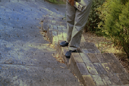

I can't explain the blue specks that you're seeing. Are they regular spaced or random? Do they look like holes or more like dust particle shapes? It may be that the red or blue channels are producing some noise because of the extended exposure time, but I doubt that's the case. Also, did you try reproducing the effect with different film?
The blue speckles are all over the road portion of the pic, and on the shoes and trousers. No blue spots were found in the plants. Here are the screenshots:
Above: Grain dissolver OFF
Above: Grain dissolver ON (blue speckles)
Above: Original photo with Grain dissolver ON
Above: Road with blue speckles (Grain Dissolver ON)
