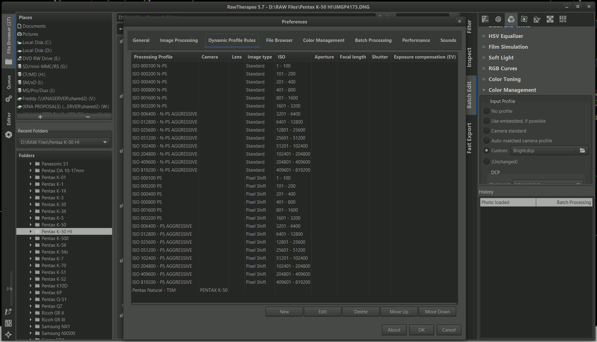

PDCU5 is very limited as far as what it can do. I mainly use it to extract jpegs out of the RAW files for quick viewing or sharing. It's a matter of selecting all RAW files, right clicking, & Extract jpeg to whatever location you need to extract them to. You can do the same thing with dcraw.c, but that requires commandline entries in Windows Command Prompt.
If you install the PP3 files correctly into the RawTherapee system folders, you can set those PP3 files as different rules with the Dynamic Profile Rules in the Preferences menu. Go to the lower left hand side of RawTherapee, click on the Preferences button, click on the Dynamic Profile Rules tab, & start entering the order of how you want the PP3 files to run.
^ That will give you an idea of what I'm talking about as far as setting rules.

Since I've installed RT5.8 over 5.7 I can't find the Pixel Shift profiles.
How can I recover them ?
03-31-2020, 07:25 AM   #143
The Squirrel Mafia's Avatar
Join Date: Jan 2015
Posts: 3,054
^ Did you have a specific set that you created? If not, you can download a new batch from HERE & install them into RawTherapee. It's a matter of picking your color space.
No they was there when I installed RT5.7 (they are located in C:\Program Files\RawTherapy\releases-win64-5.7\profiles).
Perhaps I can copy them from there to RT5.8... Or how can I change the type of Pixel Shift (Low, Medium, High and No Motion) ?

I know now what was the problem.
The profiles directory is now in user's local directory (C:\Users\[name]\AppDir\Local\RawTherapy\Profiles) and not in program files...
But the installation program installs them still in program files...
04-13-2020, 11:50 AM - 1 Like   #148

UPDATE!
I've uploaded a new set of PP3 files. There have been a few changes to the naming of the PP3 files in the TSM - PP3 Optional folder, so if you had some Dynamic Profile Rules set up, you might have to fix a few of them. There are a few minor tweaks to the noise reduction.
The biggest change for now is using RGB noise reduction & ProPhoto color space. If you want to keep on using L*a*b NR & sRGB color space, the PP3 files are in the TSM - PP3 Optional folder. You can set a Dynamic Profile Rules for them or you can witch them manually.
I removed all PP3 files that had wavelet settings. That section has been revamped a bit in the most recent DEV version of RawTherapee. The wavelet settings that I had don't really work with it. I'll be playing around with that section for a while before introducing a new batch of PP3 files for it.
So yeah. You can download a new Windows 64bit build from my Google Drive if you just want to install & use it. For the rest of you, the PP3 files have been attached below. Have fun!
