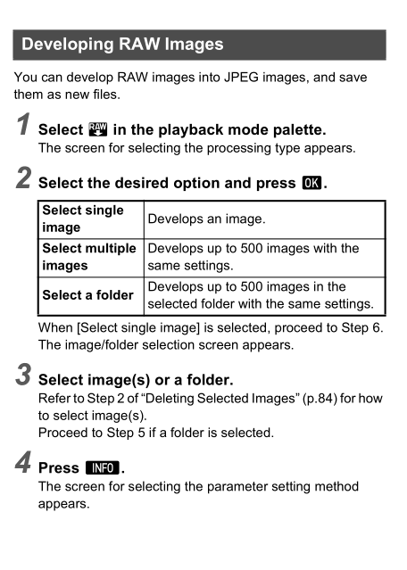

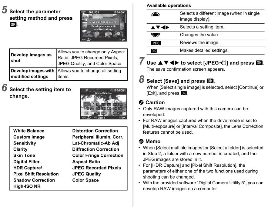

As someone mentioned earlier, even without using a computer you can just use the camera itself to batch convert DNG RAW's (a folder at a time if you want) and then save them onto your SD card as JPEGs. The K-70 manual shows how to do it (p 92-93).
