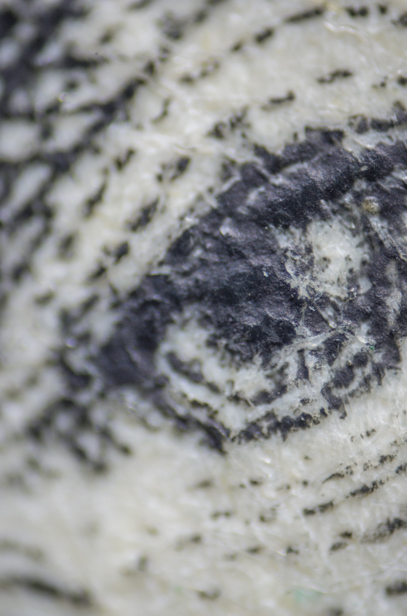

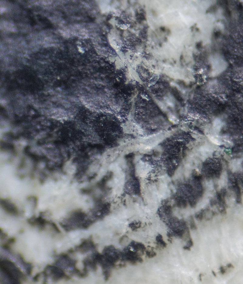

Here is the left eye of George Washington's left eye from an American Dollar Bill
Un-cropped image using the 10x objective
Cropped image using the 10x objective
