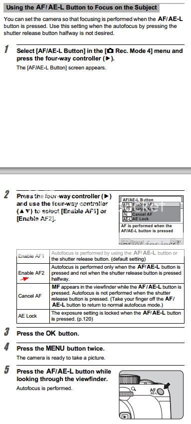

QuoteOriginally posted by Michael Piziak Quote
See if I knew how the button worked like this video shows I'd probably use it! On the Pentax, do you have to program that button to do what he's doing in the movie ?
Yes, this is the page from your manual showing how. Set your camera on AF-C for anything but low light. Low light you want AF-S so the Af Assist light will work. Use AF2 as it shuts off the shutter focusing, it will take some getting used to it not focusing. Using AF1 kind of defeats the purpose. You will have to remember that it has changed when you use your camera at first each time. Setting it up this way will focus using the Af/AEl button the way and he explains it in the video.

I see where AF1 defeats the purpose, as autofocus would be performed again by pushing the shutter release button.
One thing I don't get is why does the camera need to be set at AF-C (continuous focussing)
And for basics, it's called AF/AE-L because the button can be either used for "Auto Focus Lock" or "Auto Exposure Lock," right ?
It doesn't need to be, what AF-C allows different is if the subject moves, by holding down the AF/AEL button without release it will continue minutely adjust keeping the subject in focus or if you want to quick change your focus to another spot as long as you are holding the button it will change to that spot usually without major lens hunting. By depressing the button getting focus lock and releasing it will maintain the lock and allow a composition change without losing focus on the subject much the same as AF-S. Only with AF-S if your subject moves then you would need to refocus, which sometimes that slight movement can cause the lens to hunt which in the cause of shooting some wildlife can mean it costing the shot.
Right!
My K5 lls is different than the K-R and my K50 because it has a separate AF button and an AEL button I can still exposure lock independently as long as I don't have in the custom menu to lock AE when the AF Locks..
