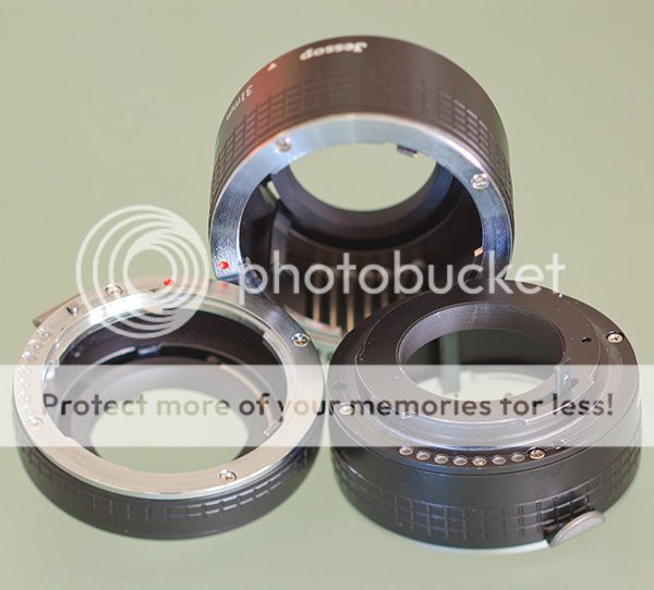

Pictured is my K10D with the 36mm tube installed :
And here are the two remaining tubes from the set ( 12mm and 20mm )
Lens is a Pentax A 50mm F1.7

Does anyone make a set of extension tubes for Pentax that have the contacts to transmit lens data. I don't care about focusing, just running the fstop and using the pttl metering for my flash. If not what makem of extension tubes do you recommend?
Thank you.

I think you will have to look on EBAY for used tubes, but be sure to look at an end view so you can see the contacts for transferring aperture data.

This set looks good, you should ask about the electrical contacts before ordering:
Firstcall Extension Tube Set DG Pentax Set of 3 - Camera Lens Accessories - Firstcall Photographic Ltd
I own a Jessops set, some are sometimes available on €bay:
