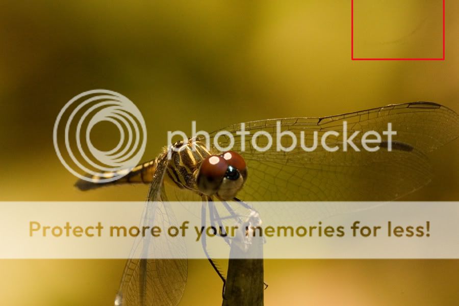

I need to clean some really stuck on dust. I can buy these items at Adorama:
Photographic Solutions Eclipse Cleaner for Sensors & Lenses , 2 Oz. Bottle
And these:
Photographic Solutions Pec*Pad Photowipes for Photographic Emulsions, 100 Sheets 4"x4"
But before I spend the extra money for the photowipes, how sensitive is the sensor? I was thinking about using a foam paint brush. They're really soft but are they soft enough?
Here's a photo of the dust spot: highlighted in the red square.

That looks like a hair stuck in the light path just ahead of the sensor.
Have you had a good hard look to see what you are trying to remove?
I don't think the sensors are as fragile as a lot of people think, but I would still shy away from foam paint brushes in favour of a proper wet cleaning system if I felt the need to wet clean a sensor.
At the same time, I doubt very much that you'd hurt anything with the foam brush either.
So how would I remove that? How would I see it?
If it is hair, how it got there, I don't know and if it's that long, where it came from because my hair is only about an inch long.

I still don't know how to remove it if it's a hair and stuck in there before the sensor. I tried dust off just now, twice. I can't see a hair in there but I don't have a powerful magnifying glass or loupe either.
I can always crop the offending spot out but I'd rather have it gone.
Edit: I forgot about the magnifying piece I removed from another lens I had that was broken. It was strong enough with a small flash light for me to see what this thing was. It's not a hair. It looks like a smear of some kind. I'm going to order what Paul suggested, now.

Definitely time for a wet clean then.

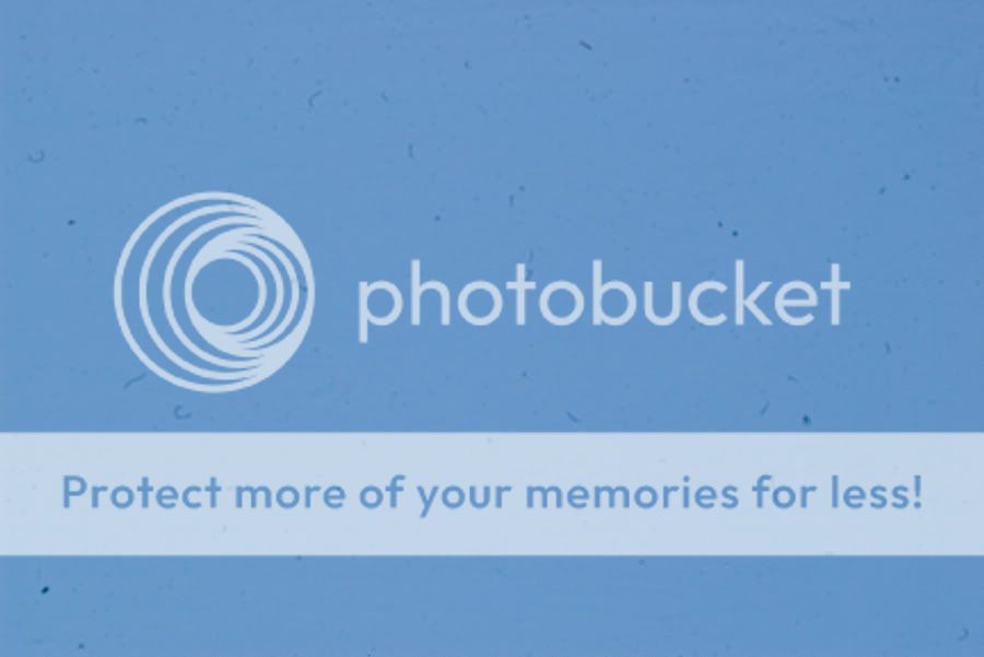

Now it's worse. Look at what that sensor cleaner did to my camera. Those are streaks from the pec pads and pec pad paddles. I've tried to fix it, but can't get the streaks out. Now what do I do?

I've used the products in that kit but have Never had a result like that. It looks like you got the origintal spot though. Can you explain Exactly what you did so that we may help you?

Never mind. I just panicked when I saw this. I have now fixed it by making a new swab using the full pec pads and paddle.

Hi Jeff guess we were writing and posting at same time. But it's fixed now. I think it had to do with me applying pressure. I think it was too much and didn't help that my hands were shaky to start with. Hands are calmer now and I was able to fix it.
