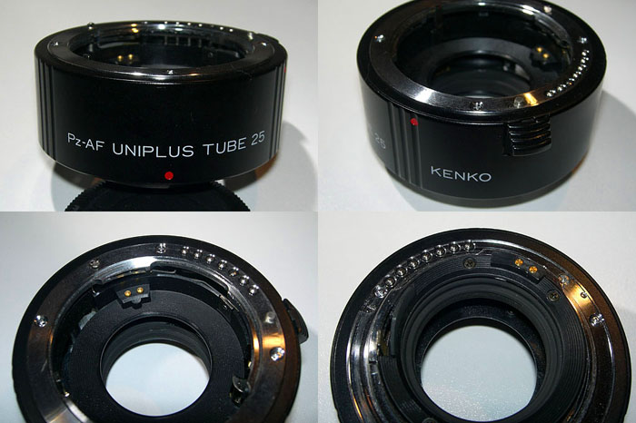

QuoteOriginally posted by excanonfd Quote
Does the AF work at all with the Kenko tubes in macro mode, and to what degree - not that I see myself getting one anytime soon but I am curious about Kenko's own recommendation to use manual focus in macro mode.
I have the Kenko Uniplus Tube 25.
It is the only one I know that works.
It works without problems with SDM lenses. SDM-AF works.

Posts: 1,421
Thanks blende8 for the pictures - $80.00 for one 25mm extension tube, pretty expensive!
