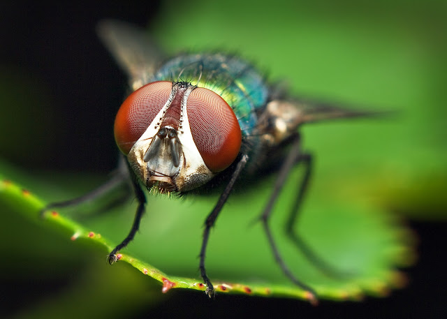

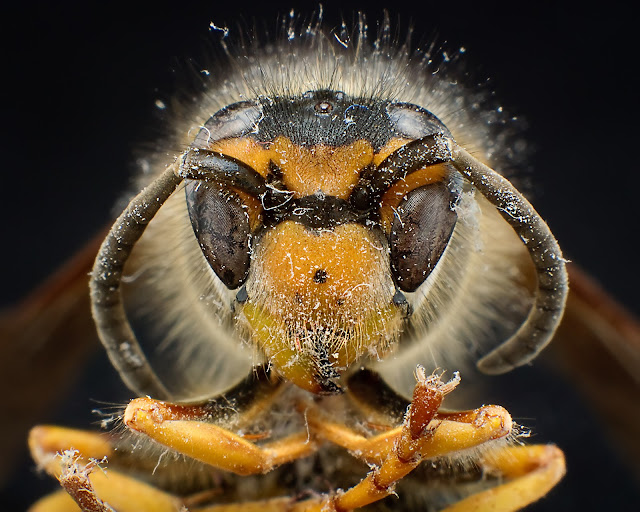

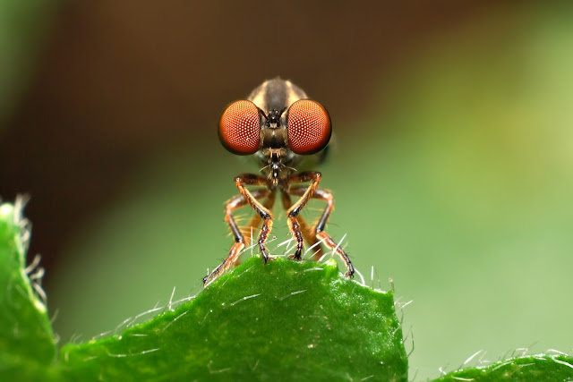

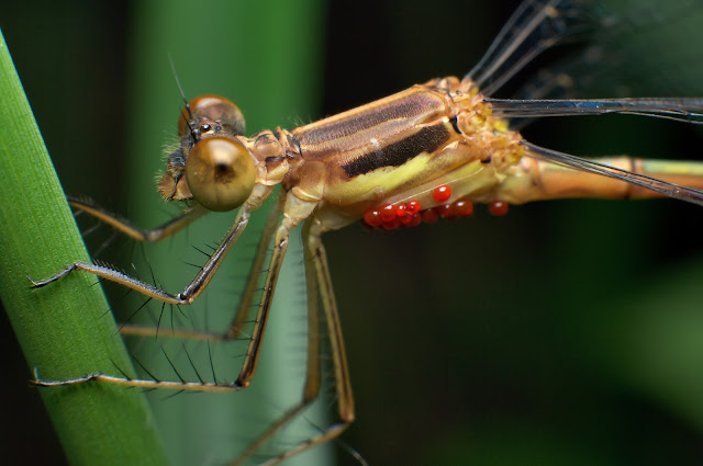

There really isn't such a thing as macro mode on a DLSR. Some of them have a wheel setting for macro, but all that might do is lower the ISO and change the color/contrast settings. I use a flash for my work, so the low light/stabilization doesn't really matter that much.
You can get a "macro" lens for cheap with old pentax film lenses. Grab some extension tubes and/or a reverse ring and a 50mm/28mm manual lens. Total cost = $85 or so.
results?
from my older K20D, i'd say the results look just fine.

Hi enoeske,
Thanks so much for your reply. Those photos are amazing! I love, love, love them. That's the kind of thing I'd love to get into. I just tried searching online for 28mm lenses but they came up quite expensive; maybe I'm no searching correctly?
When you say $85 - do you mean just for the extension tubes and/or a reverse ring? Or a lens as well?

QuoteOriginally posted by enoeske Quote
I used the extension tubes and 50mm for my shots.
But you reversed the lens, right?
Also it seems you used a flash with a diffuser?
12-10-2010, 06:22 AM - 1 Like   #10
enoeske's Avatar
Location: Surprise, Az
Posts: 1,888
The first image of the fly, that had my 50mm reversed on a set of extension tubes. Its rather difficult in that the aperture is stuck closed down and almost no light gets through to see your subject and help you focus. You can hold the lever down to focus, then let go and shoot, but then your hand is awfully close to the subject. You would get even more magnification if you used the 28mm reversed.
The other are just a 50mm straight on the extension tubes. I used auto extension tubes from vivitar that has the aperture lever. Still fully manual, but the lens isn't always stopped down and focussing is much easier.

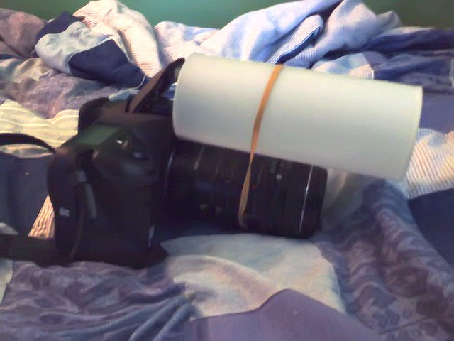

here's my elegant setup:
there's some tin foil at the end of the tube inside that makes a quarter circle shape, directing the light down in front of the lens.
Thanks a lot for sharing!
I'm amazed that you didn't scare your tiny subjects away with this, what must appear to them like a, battleship.
