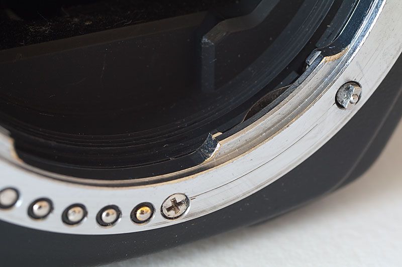

I wouldn't worry much about lens mount wear. Think of it as saving wear on your camera's mount. After 4+ years and hundreds of lenses, here's what my old camera looked like:

As for the wear marks, I think they were there in the packaged lens, before I put them on.
