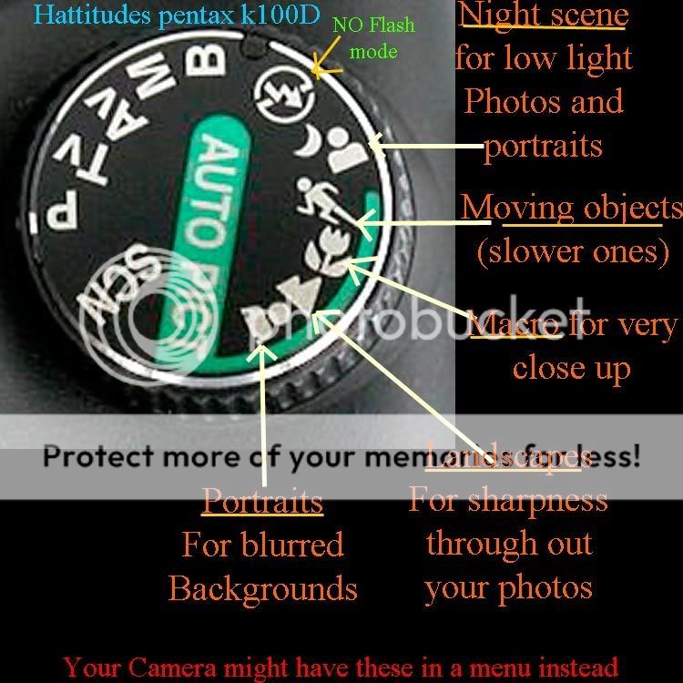

your camera might be close to these..
link to the full tutorial
Question Aperture/Shutter relationship!!? - Digital Scrapbook Place
hope this helps
cheers

Helpful except for one error in the first image; sharpest should be between about f:5.6 & f:11
I know you are not responsible here and I appreciate your posting helpful stuff but feel it it is important to not let errors persist regardless of their source's authority.
Also Tv and Av may be easier to remember as "Time value" and "Aperture value".

what is meant in the chart that the backgroud blur/ sharpness is a progression, not an exact setting.
thanks for the time value, apeture value tip, I am going to use that myself to remember
