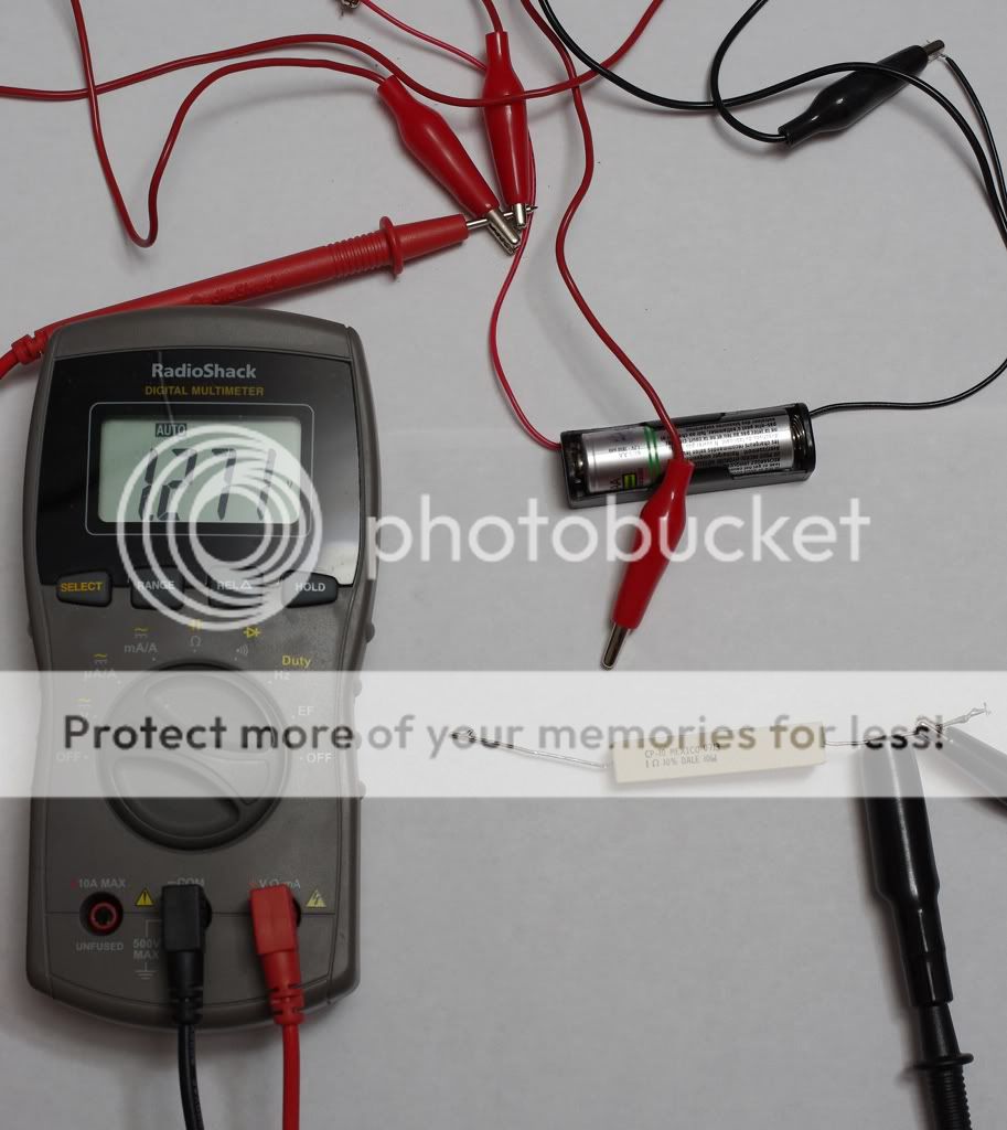

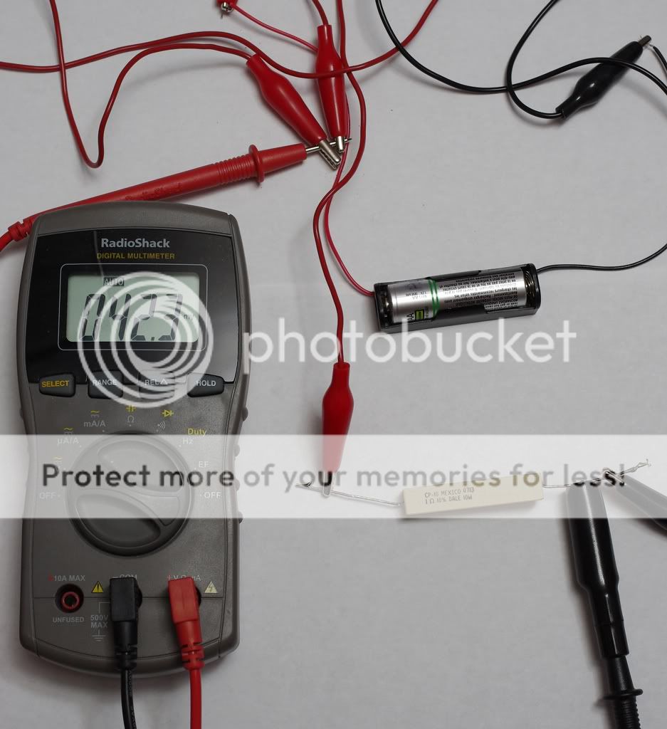

QuoteOriginally posted by OutOfFocus Quote
You have to measure voltage under heavy load. Under no load, even very, very depleted NiMH will read high voltages. Put a 1.5 ohm 5 watt resistor in parallel with each battery to read the voltage.
I thought couple of images to illustrate this couldn't hurt. I rummaged around and found an ancient Energizer 1850 mAh battery that has somehow managed to escape being recycled. This was a decent enough battery in its time, but that was long ago. Now it exhibits high internal resistance.
The first photo shows the open circuit (unloaded) voltage: 1.271 volts.
The second photo shows the voltage a few moments later, very soon after I connected a 1.0 ohm resistor in parallel to the battery. It now reads 42.3 millivolts, or 0.042 volts. Ouch.
After the load was removed, the battery quickly recovered to a high open circuit voltage.
This is a very high load, probably somewhat higher than what the K-x actually draws, but you get the idea.
An eneloop (not shown) maintained a voltage slightly over 1 volt.
