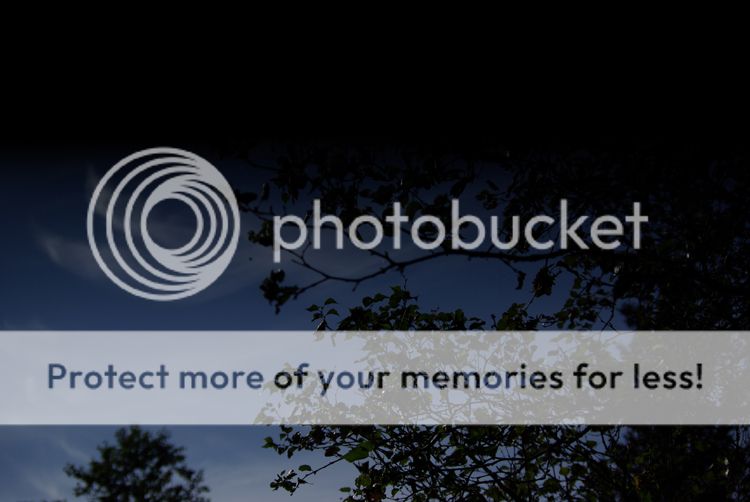

Of course, a photo is worth a thousand words... 1/2000s, f/5.6, ISO 100, was on spot metering but it is the same on other metering modes. Pentax 50-200mm.

The mirror flips UP. The image hits the sensor upside down. So, the darkness across the top of the image should be something blocking the bottom of the sensor. What, I don't know. But if I'm right, it can't be the mirror.

my guess would be shutter failure. I would try to get a refund if so.

That's what it seems to be after a thorough search on the forums. Thanks. Will try the refund approach and go from there....
