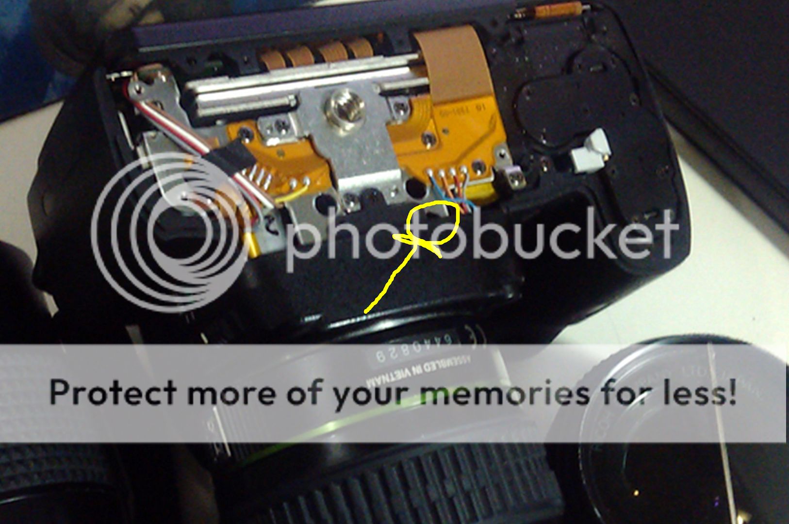

I've bought my K-r 1 year ago, this is my first DSLR so at first I did not notice focus problem on manual lenses.
on the DA 18 55 II kit lens it seems no focus problem.
I tried a rikoh 50/1.7 and another 135/2.8 on the camera both heavily lose focus.
both lenses can only focus on center point, on in focus the hex indicator lights, press the shutter the picture get always out of focus.
  • so I adjusted AF fine adjustment from the menu got nothing improved, but got the kit-lens out of focus. so cancelled this method.
  • after months, using Pentax's engineering mode software, focus calibration done on 135mm, the 50 lens and the 18 55 had failed. if calibrate on 50 the 135 would fail.
  • and later one day i opened k-r's bottom cover, found two screw, which hiding deeply in a hole but can twist with a screwDriver, this must be for focus adjusting. I carefully turn both screw with same amount same direction, result is the same with engineering mode focus calibration. so i'm almost disappointed and gave up.
  • today I thought what if turn focus screw independently? so i just tried, and got it fixed.
table in the attachment shows the operation and results. there are tools used to the procedure too.
Is there any service manual or something that telling how to calibrate? even though now my camera could focus on ricoh 50/1.7 and another maunal 135/2.8 lens roughly, without problem on kit lens. but the focus accuracy is not assured, and all have i done is just experiment, there is no theoretical instructions. seems that on my k-r left screw calibration effects longer focus range, and, right screw have no effect on this.

There are three screws! Two of them tilt the AF module side to side, the third moves it back and forth (up/down), just like a pan/tilt tripod head. I have the third screw marked in yellow for you in the pic below. Good news is all Pentax dSLRs have used this system to adjust the AF module. So I can give a link to a bunch of manuals (passcode 8639) for you to look at. But your suppose to use special equipment to do this adjustment. A computer really adjusts with humans turning screws. The small AF mirror can be adjusted, the Shake Reduction platter can be adjusted. There are many AF adjustments. All need special software and machines. I am not trying to discourage you. But want to inform you. The task of building a dSLR with high mega-pixel sensors, have the camera used in very hot and very cold weather (makes metal expand/contract), be bumped around and still keep tack sharp perfect focus with any lens (that may not be exact in its build) is daunting to say the least. And I would guess the more mega-pixels the more demands on the whole system including lens. Its truly mirrorless number one benefits. But I would not go mirrorless unless I could not get a dSLR.
Also the poster above, I agree with. You do not need to tune your dSLR when using manual lens. I see no need for it. When shooting at night under artificial light I know the AF will not be right anyways so I use my eyes to AF. You are harming your fully automatic focus lens by doing this. All lens do differ. Yes I do tune my lens (with a K20D) separate. But not by much I could just park it at +-0. If your focus is off that much...
As you now know those screws are held in place by glue. I strongly suggest just letting Pentax service tune it for you, the cost is not that much. Not cheap, but not expensive relative to the whole hobby. It will be as good as it can be without adjusting major components. Then you can focus on your lens (pun...?). Sometimes just getting new lens and selling the old ones till you get one that works great on your dSLR is a good thing. I have a set of lens (luck first time lens) that works perfect on my dSLR and I won't sell them. Now its not a bad thing to sell your bad lens because they may work great on someone else's dSLR. The chances are really pretty good.

If you still read this on 2018, left screw turned ccw around 60 degrees worked for me, spot on and did not affect AF..I was having the FF issue with all manual lens..
