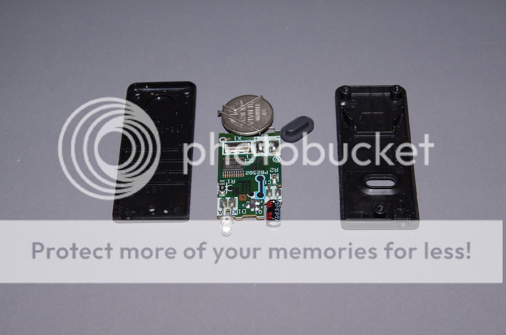

I bought a remote F a while back and still can't get it to work. was new in box.
I took these pics as the inside looks different then the other example on the site
could someone please tell me if I put it together properly or do I have a part missing? it doesn't have the "airplane" type clip but the spring setup that holds the battery is different looking as well.
any help much welcomed!

I took mine apart to see the battery number its a 3v lithium renata CR 1620 (Swiss Made). If your first battery was wrong then the rest will be. I can't see the second to last number on your battery. But that's all I have.

QuoteOriginally posted by jamesm007 Quote
Thanks for showing me this assembly as I at least know I have all the parts
Randy
