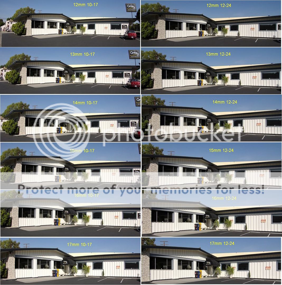

I thought that it might be interesting to compare both - a fisheye and a normal lens together, apples to apples - i.e., when the fisheye is defished into a normal image. This way, you can actually see what the differences are between the two types of lenses.

QuoteOriginally posted by interested_observer Quote
oh, wow . thanks! So.. this Rokinon 8mm states it's an "ultra-wide angle fish eye"
What is it really..? A fish eye then ?

QuoteOriginally posted by steezylistic Quote
It's a fisheye. Both fisheye and wide-angle rectilinear lenses use distortion to get a really wide field of view. They stretch and pull in different ways. Rectilinear lenses distort in a way that looks less unusual at first. Fisheye distortion allows a lot more field of view to be crammed into the frame.
Bob mentioned the world map analogy and it makes a lot of sense to me. Paper world maps always distort the shapes of land masses to get a round world on a flat piece of paper, and lenses do the same thing.
The fisheye lenses are rated in millimeters like all lenses but this is somewhat misleading. If you look at fields of view, the DA 10-17mm fisheye zoom has the same field of view at 17mm as the DA 12-24mm rectilinear zoom does at 12mm.
Look at the Lens Club threads to see a lot of examples of either type.
