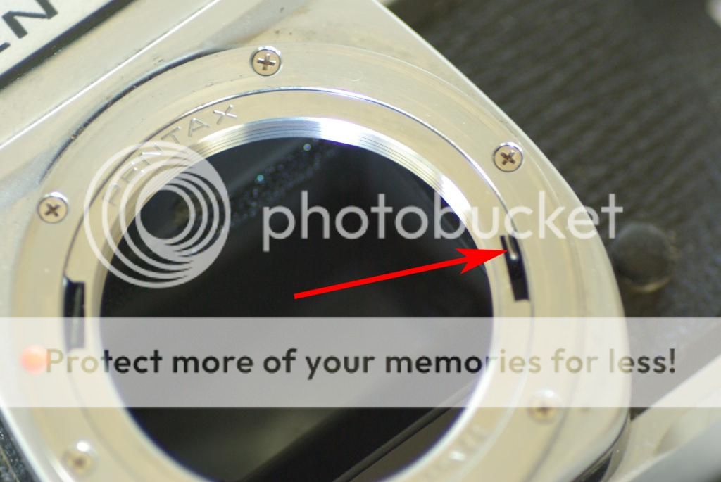

The problem most likely is the auto release pin on the Takumar. Since you say the auto/manual switch won't operate I'm fairly certain this is the case. The notches on 3rd party adapters allow this pin to pop out and then catch on the adapter when you try do unscrew the lens. A solution is to slip a thin sheet of metal between the lens and camera mounts to push the pin back in. Suggestions are - thinnest feeler gauge used in automotive repair shops, a section of a beer or soda pop can, single edge razor blade.
If you face the lens pointing towards you the pin is at the 9 o'clock position relative to the red diamond focus mark.
See this thread post #10 illustrates the problem.
https://www.pentaxforums.com/forums/general-technical-troubleshooting/222627-...ck-camera.html
Users say that the adapter that SRB sells works as well as the OEM Pentax adapter. Otherwise it is recommended to remove the spring clip on 3rd party adapters.
http://www.srb-griturn.com/pentax-k-to-m42-3355-p.asp

I only have the OEM adapter but you can see where the slots are relative to the red mounting alignment mark on the mount. If the slots are in the same position on the Neewer adapter I would guess the pin is in the slot near the 4 o'clock position. If you were able to unscrew the lens about a quarter to half turn before it got stuck that would be the most probably position.
Since the pin is on the lens you would have to located it relative to a landmark on the lens. The red diamond is on the Depth of Field Scale next to the Distance scale on the focus ring.
Although I used the photo for a different purpose the red arrow just happens to be pointing to the slot that I suspect the pin protruding into.

I agree that this is your problem. Feeler gauges are the only tool that I can think of to work. They are thin enough for the gap and stiff enough to move the pin.
If that fails, I would not do anything to the camera mount. The screws are tempting because you can see them, but I'm worried about getting the mount back together. It is possible to disassemble the lens to get to the other side of the tiny pin and pull it up. The lens is different here but construction is similar. You'd go to about step 8 to get the rest of the lens off the mount, then you would have to disassemble some of tat mechanism to access the other side of the pin.
