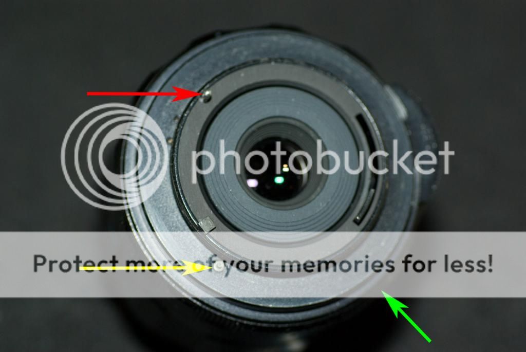

The pin in question is the auto/manual lock/release pin. It is not visible in the photo you show.

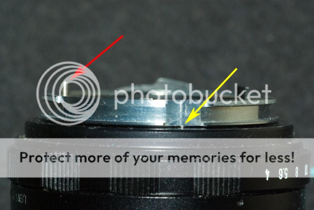

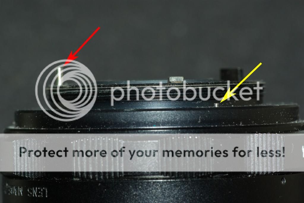

Here is my Super-Multi-Coated Takumar 50mm Macro f/4. Not the greatest photos but I was too lazy to set up the white box and just used a flash in the shoe. The red arrow indicates the auto diaphragm stop-don pin, yellow indicates the auto/manual lock/release pin and green indicates where the focus diamond would be.
side view
side view with OEM m42 adapter installed, loosened about 1/3 of a turn
On most 3rd party adapters the slot is cut too deeply allowing the pin to pop out. The OEM adapter leaves enough material to cover about 1/2 the pin keeping it from catching in the slot. See the also the photos in the thread I linked above:
