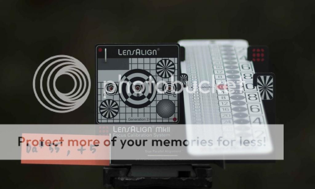

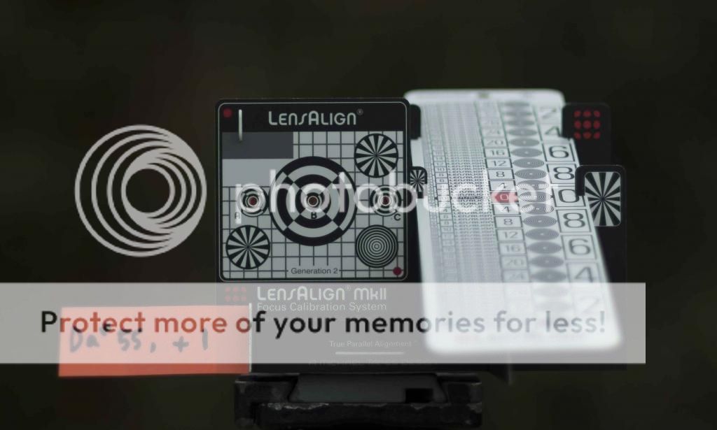

ok ,Does it look like the Da* 55 needed a +3 AF Microfine adjustment using the LensAlign Calibration system to get the Zero sharpest ?
All shots were taken wideopen with both Camera and Lens align on tripod and level.
No. 1 ( No Adjustment )
No 2. ( + 1 Adjustment )
No 3. ( + 2 Adjustment )
No 4. ( + 3 Adjustment )
No 5. ( + 4 Adjustment )
No 6. ( + 5 Adjustments )
I spent a Considerable amount of time setting up the Lens Align and taking test shots to ensure I had the Bulls eye dead centre and that the Plane of Focus was parallel to the sensor plane there was no Error Introduced.
