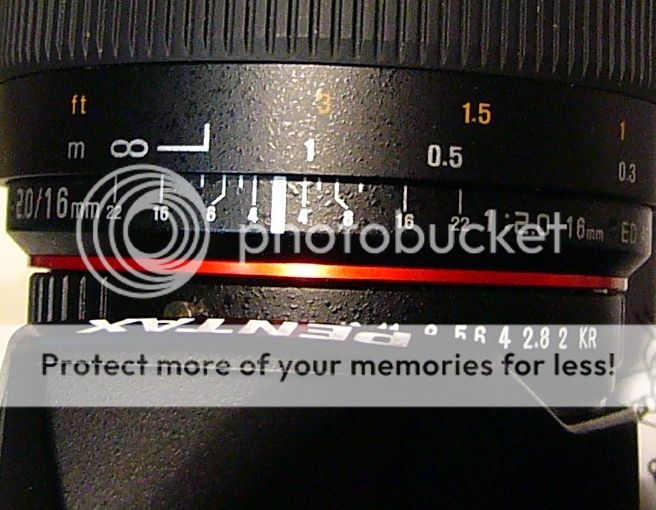

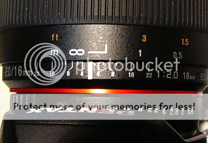

I went to take night sky shots tonight and found a weird thing about my new Samyang 16mm F2.0.
It's not easy trying to focus on stars with a manual lens and this lens made it harder.
I took half a dozen shots set to infinity then uploaded them the my computer and discovered they were all very out of focus.
So then I went back out and took another 10 shots, moving the focus ring slightly away from infinity with each shot.
I found true infinity to be a long way from where the ring actually stops. Now I know some lenses can be slightly of the mark but I feel this one is just too far out.
Ok so I thought I might check the other end just to see what happens.

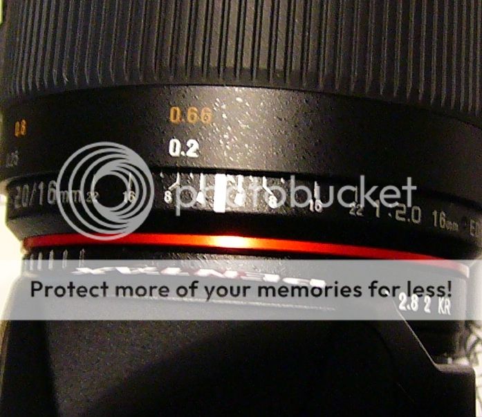

The specs for this lens say closest focus is at 20cm, well my copy will focus at 8cm. That's a bonus that I like, but one of the main reasons I purchased this lens in the first place was for star shots and the way the focus ring markings are placed makes that a real chore.
Now for the pics.
First one shows infinity stop.
Second one shows actual infinity position.
Third is close up stop.
Should I send this lens back and get a replacement ?

This has always been a problem of the wide angle samyangs. Had to adjust both my 8mm and 14mm. I imagine this design is very similar to mine. You can easily adjust it yourself. Lift the rubber on the focus ring slightly until you expose the screws. Then set the infinity now at the accurate infinity position. Unscrew the screw (not needed to remove them just slightly loosen). Set the infinity symbol to where it's supposed to be. Retighten them and cover w the rubber. All in all 5 min of work. Your Next lens will prob also have this problem. :/

That sounds ok but is it the external ring that hits the stops or the internal mechanism ?
because if it's the external ring and I adjust it to the correct mark, it will still be way past where infinity really is.
What I mean is, if I could adjust the mark to where the stop is, then I can find infinity even in the dark. Else the stop will still be past infinity.

The physical stop is on the focus ring itself. If set infinity at the right place, you will no longer be able to go past it. Not sure if this answers your question.

Yes that's what it should be so I'll try that adjustment.

the lens doesn't have a hard infinity stop. This is done so that : a) less QC and precision is needed, which lowers costs and b) it guarantees that infinity will be somewhere on the ring and not "beyond" it. This also helps because the temperatures can affect materials and throw off the distance scales
Finally, there was much debate over whether the Samynag 14mm has distance scales calibrated for Canon instead of Pentax, which would be just a mistake.
But your lens is behaving normally. The problem with adjusting it is that its difficult to tell where infinity is through the viewfinder and you don't want to accidentally prevent the lens from reaching infinity.
Also, the minimum focus distance is not 8cm. The MFD measures from the sensor to the closest possible subject, NOT from the front of the lens (that is usually called working distance). So if you take 8cm+lens length+register distance, you will notice the MFD is not actually far off

I don't think it is a Samyang thing. Many modern lenses allow the focus go pass infinity slightly, I read somewhere it is to avoid hard stop due to the strong motor that modern camera uses that drive AF.
My PENTAX 16-50 is like that (though not that much off).
If you read how to take night skies tutorial, most would suggest you find out your lens 'true infinity' before dark and switch to MF and tape the focusing ring.
so definitely not a Samyang thing.
