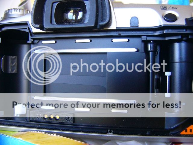

Just wondering if anyone has seen a fix for this.
Mz-50 shutter wont go fully closed , that is all the way to the bottom.
As soon as the camera is turned on it emits a motor sound for about 1 sec and with the back open I can see that it's trying to close the shutter fully. This also happens with the press of any button.
First photo is a good MZ-50 shutter.
Second is the bad one.

Can you get it to fully open in bulb mode? Then you could check for any bits of debris in the shutter channel...
05-14-2014, 10:22 PM   #3
Location: Christchurch, New Zealand
Posts: 1,453
The MZ series where known for having a plastic gear in the film and shutter advance machanism that would get shredded over time.
The repair was to replace the plastic gear, preferably with a metal one.

While I was looking at it, one of the flat ribbon cables broke so it has now been binned.
Thanks anyway.
