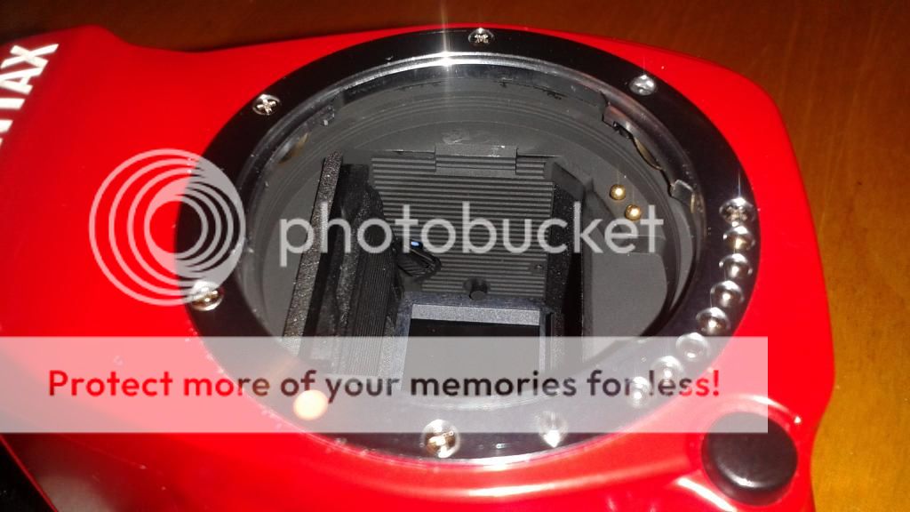

mirror always up, shutter stays closed, and camera operates slowly
Hello forum!
ran into a weird problem with the kr i purchased for my little sister. the mirror stays up constantly. the shutter is closed over the sensor permanently, and the camera is very slow to respond to any and all buttons. My sister tells me the camera had intermittent issues related to the mirror or shutter flap starting a month ago and recently nothing in there will move upon turning the power on. I looked at other smirror flop threads but they show pictures of the mirror down so I am not sure if my issue is similar. let me know if you guys and gals have any suggestions as to what may fix this promlen, thanks!

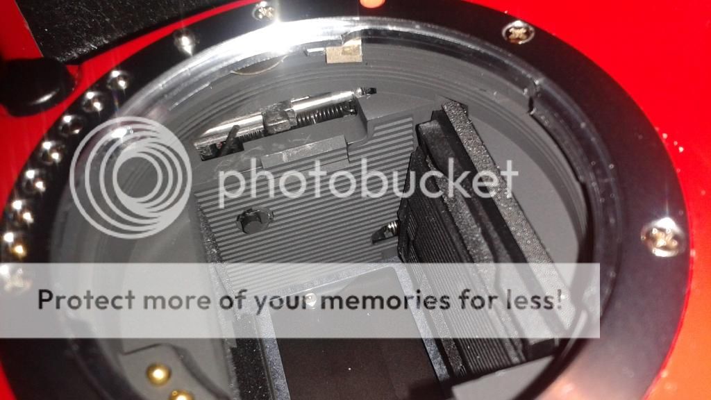

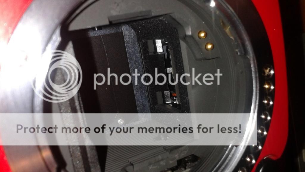

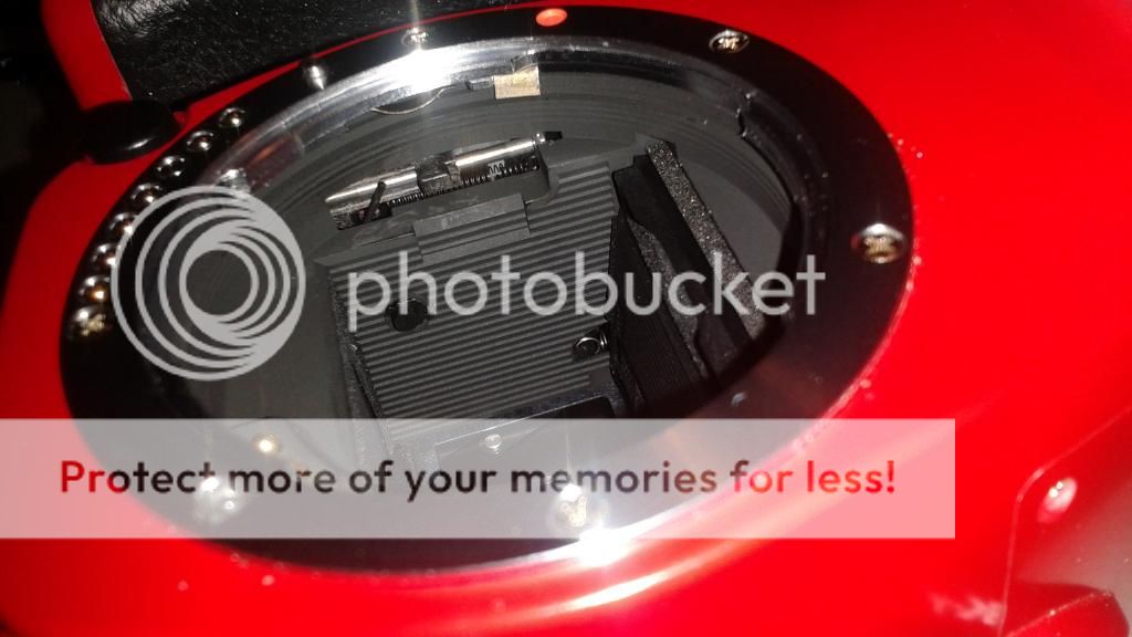

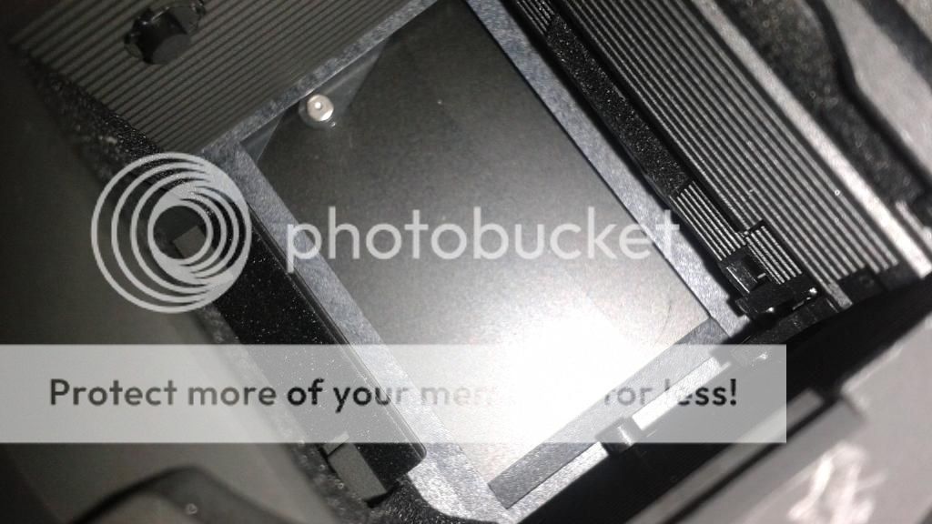

hey guys, thanks for the help! i tried the mirror cleaning tip but it didn't free it up, very slight movement. is there a lever of some kind i can push on while trying the mirror up trick that might help? here's pictures of whats going on in there
My first question would be, "How did the inside of your mirror box get all biffed up?" There are scuff marks on the paint on both sides. I don't have a K-r to compare with, but that little metal springy looking thing sticking up below the aperture actuator does not look like it belongs there.
When there are problems with the movement of mirror, shutter, or aperture actuator there is usually little that can be done outside a service facility. All three are electronically controlled in a strict sequence and failure of any part of the sequence leads to failure of the whole. I am sorry to sound so grim, but repairs of this sort are likely to be over $200 USD.

The "spingy" thing is one leg of a spring that is part of gear box. When I do a "B" shutter I can see it stick up there when mirror is up, as your picture shown. I am not sure the actuator is correct or not. It will depends on the aperture setting when the mirror got stuck. Although the gears for actuator and mirror are independent but they do drive by the same motor.
Did you use any "lens adapter" by any chance? An improper placed aperture lever my force the aperture traveler too much and has it bite on the shaft. Also, one spot at return coil spring does look suspicious. It looks like part of gear that is part of traveler.

This is the springy thing that I mean.

That is correct. That is the first part of the post I point out. It is normal when the mirror is up. I don't have another camera handy to take picture to shown right now.
The picture I attached is the extra piece shown on third photo from michaelwoodcock's post which looks like broke away from the slider. It is not shown on other photos so possible is a loose piece. The teeth are the part engage with a gear wheel that push slider travel on the shaft.
Ok, here is a shot of my K-m which has similar structure. The end of a spring stick out when mirror is up. The slider travel all the way to the right(top).
I think I may have an answer to this. Canon shooters have access to a device (in-body light pollution filter) that is used for astrophotography. The filter clips into the mirror box of a Canon camera, but may interfere with the works when used with other brands. It would leave marks similar to those in the photo. Is there any chance your sister's camera had such a filter mounted at some point?

I was thinking in terms of the previous owners. Perhaps used as below:

I am more curious about this part of coil spring in pictures. For one, they are different in photos you posted which indicate there is something loose in the gear box. Second, it looks like part of linear gear on the slider. I think something is broken. Likely some broken parts got stuck on one of the gear to prevent it from move.
The traveler engage with aperture lever on the lens but not very easy to wear out. My K-m is fairly new as it is acquired lately (as with broken AF but very low shutter count. I fixed AF). It also possible that Pentax "improved" for K-r. K-m is an older model.
