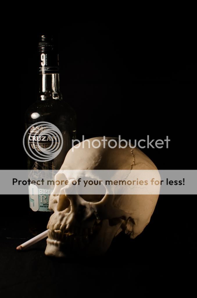

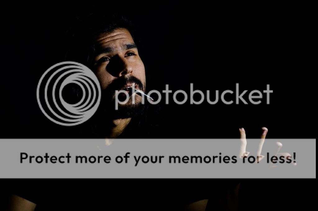

These are the kinds of photos we were taking if that helps you get what I am going for. These were taken on his D7000 since my K5II wasn't playing along.
