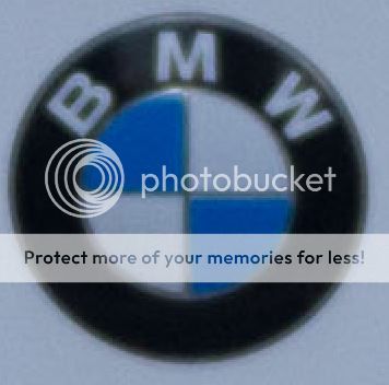

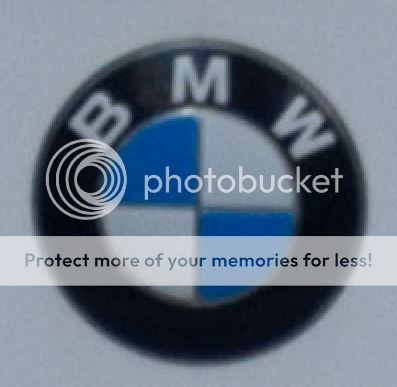

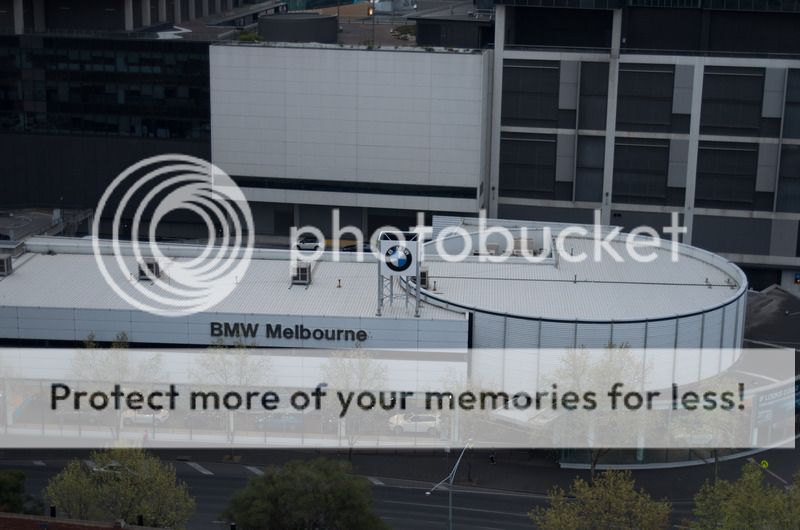

I have also carried out a the other test you recommended. I used the BMW logo on the top of the dealership approximately 70 meters away as a point of reference and focused 2 on my lenses to infinity using x8 magnified live view. On my sigma I am able to go beyond infinity, however on my DA40mm i have to go all the way to the stop. both photos appear sharp, however if you zoom in much closer (x23) you can see ghosting round the letters in the shot taken with the DA40mm.
As such using manual focus to infinity with extreme magnification I am able to get a better result with the Sigma. I have included 2x 23x magnification crops from both lenses.
Sigma: 24-60mm (focal length for shot 40mm) at F2.8 (23x magnification of the logo on the sign)
Pentax DA 40mm at F2.8 (23x magnification of the logo on the sign)
for reference for the level of magnification in the crops this is the original sigma image:
What I don't know is whether this is a result of a problem with the lens (i.e. incorrectly calibrated infinity stop), or just a limitation of the optical ability of the lens + camera +me. I also wonder whether the pentax lens should focus past infinity in normal operation? As mine most definitely does not.
