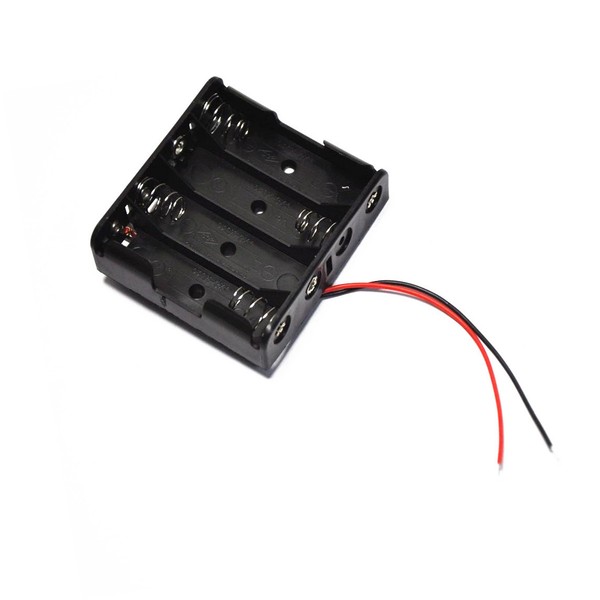

Thanks, all! Your responses have been immensely helpful. (I really appreciate the considerate tone and content of this place.) It sounds like mine is a chronic issue without a practical/easy fix, so the path forward seems pretty simple.
Since this body only has 488 snaps through it and has been good to me otherwise, I will probably rig up an external battery supply to feed through the AC socket while I ponder its successor. (Which will definitely have some sort of Li-Ion pack. Between digicams and bicycle lights, I'm through with juggling AA and AAA rechargeables!)

05-01-2016, 11:50 AM   #12
Join Date: Mar 2016
Location: dfw.tx.us
Posts: 296
Will do.
(I was just going to wire up one of these types to the correct plug type, so I guess I'm not completely done with AAs.)
