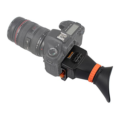

As for aids, I got my hands on a magnifying hoodloupe for the LCD. It definitely makes focusing in Live View a lot easier. The added size is a drawback, of course, as well as being hard to use with the flippy screen of the K-70. Not my image, but this one works well with my K-3.
