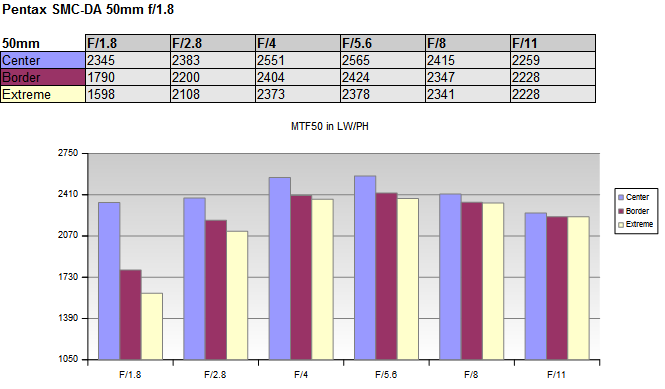

Go here
Pentax K Lens Tests
For graphs like this
The first thing you learn from graphs like this is, it really doesn't make much difference. Shooting in the field you realize Depth of Field usually has more effect on the appearance of sharpness than does absolute sharpness. Personally, I'd use the above lens anywhere from ƒ4 to f-11, depending on how much depth of field I wanted for the shot.
I've done lots of images where I took 4 or 5 images ƒ2.8, 5.6 8, 11, 16. You rarely notice much difference in sharpness. You'll notice big differences in how the out of focus areas are rendered.
From my perspective, thinking about absolute sharpness, you're sort of barking up the wrong tree. The above chart can only be worthwhile photographing flat surfaces parallel to the sensor plane. On any other type of image how the scene is rendered is much more important. And that changes for each format at the same f-stop.
to be fair, my default settings on my camera are ƒ5.6 on APS_c and ƒ8 on the K-1, because that's where many of my images end up. Sharpest part of the lens in most cases (until you get really good lenses, like over $1000 dollars, although a DA 70 is sharpest at ƒ4.) And pretty much middle of the road DoF. So I start at the sharpest flat plane settings, then alter my aperture to achieve the rendering i want. With the above numbers being the defaults.
This is very informational. I will have to take a closer look at this chart later on. Thank you very much!
