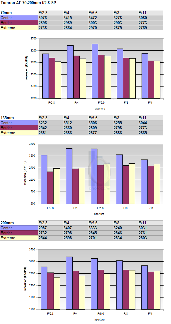

But given what you've said I'd suggest a used K-5 and a used Tamron 70-200 is the best possible combination that will get you what you want as close as possible to your budget.
Many of the cheaper cameras you might purchase still don't have the rating a K-5 does, and that Tamron if it's a good copy is excellent. However the out of box failure are was pretty high, close to 10% by forum reports.. You have to make sure you don't get one from the low end of the sample. It's also a pretty heavy beast.

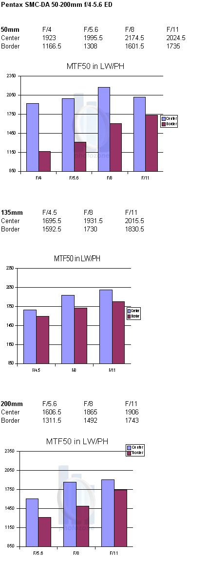

A lens I've avoided and have heard very little commentary on. Maybe you could tell us more about it, but I'm not sure t would be better than a Sigma or Tamron 70-300. Those 70-300 are excellent lenses up to about 200mm, but they are a little soft in the long end. If the 50-200 is sharp until 135 mm and then weak in the long end it might be a serious step down and not even worth keeping. I have absolutely no problem using a 70-300 as a 70-210, with excellent results.
Opticl limits would suggest that is the case even with lower MP camera. That will be seriously accentuated with modern sensors.
The Tamron still has an excellent centre at ƒ8 and 200mm, so the 50-200 would likely be a step down.
Tamron AF 70-300mm f/4-5.6 SP Di VC USD (FX) - Review / Test Report - Analysis
Compared to the Tamron 70-200 these lenses are simply inferior, and that will show up even on 10 MP cameras.
In my experience 200 lw/ph difference is visible in eye tests with careful examination, but just barely visible even pixel peeping. What I look for in these graphs because they aren't really comparable numerically, is how much of their range is rated as excellent on the graphs. The Tamron 70-200 is rated excellent in 10 of 36 metics, and that is darn hard to beat.
