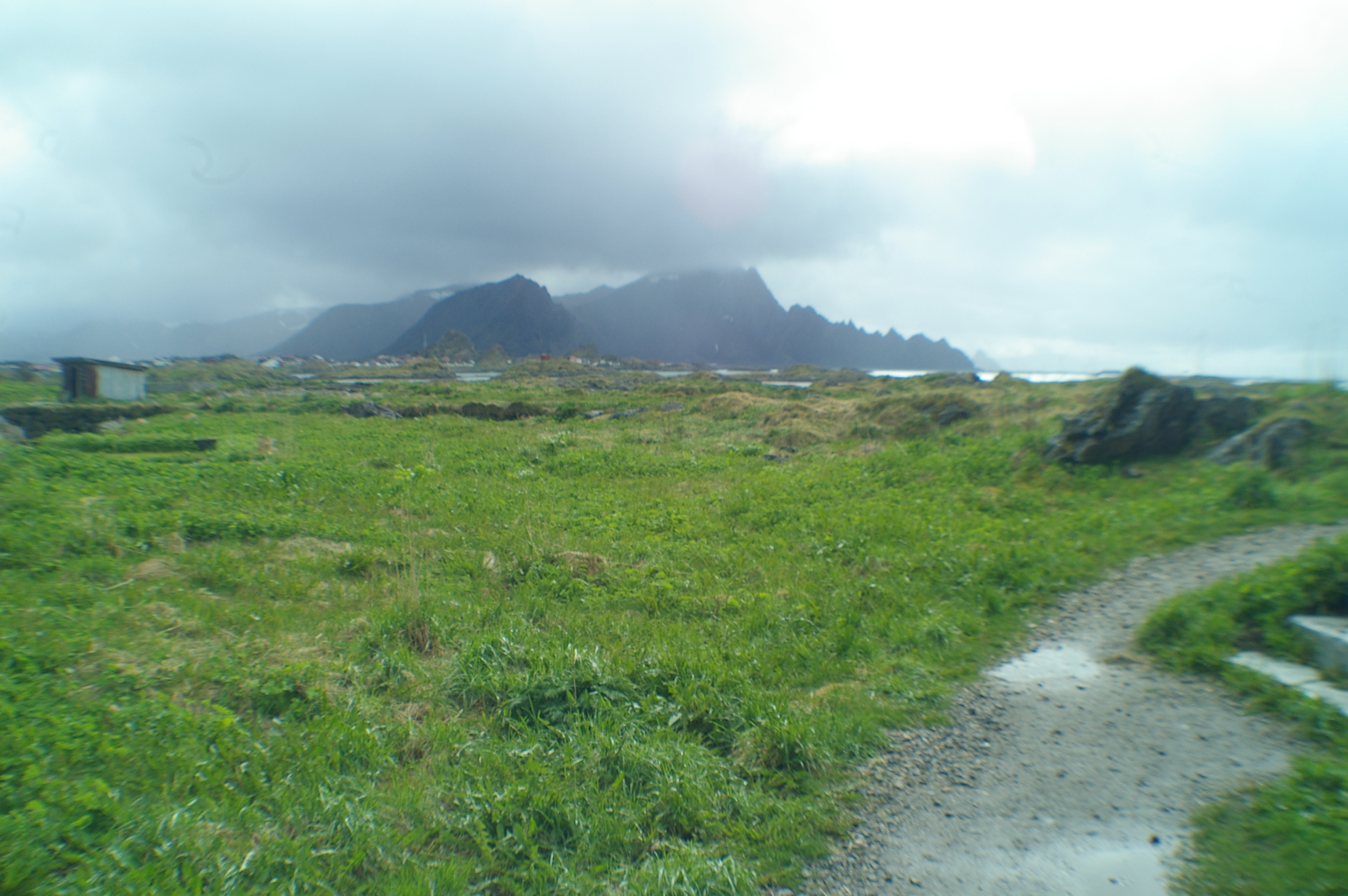

Here are some examples of the same landscape I took with 3 different angles
wide-angle
"maximal zoom"
and last...
WTF is this mode ??? Looks like a backwards zoom, what's the point? I can't make heads or tails of it.

QuoteOriginally posted by Aeglil Quote
The blurriness in those photos is caused by the add-on wide angle adapter that you've got screwed onto the front of your lens. That sort of adapter ALWAYS causes blurriness like that.
To repeat: You have got an adapter screwed onto the front of your lens that is causing the problems that you are seeing in your photographs.
You need to unscrew that adapter and stop using it. Once you've done that, you'll find that all those problems go away.
The adapter is the thing that says Bower I.R. Super Wide. That's what you need to remove. It might be stiff to get it unscrewed but it's your only solution.
wide-angle
"maximal zoom"
and last...
In the past I used Fujifilm, Nikkon, Canon and Lumix Panasonic cameras, some of them were quite expensive models, and I was entirely satisfied with them. I don't know how much money my father put in this camera, but it looks like an entry-model level.
I need this camera to photograph animals in the wild (mostly whales when I'm out at sea), and I can't get the best of it. All the whales look so far away.
One more time. Remove the auxiliary lens. That weird view is caused by that adapter. Clearly the underlying lens is a zoom and at some focal length settings it isn’t able to cover the entire sensor with that auxiliary lens attached to the main lens. Likely your dad only used it at the settings where it worked and perhaps only as an experiment. I would suggest again that you remove it and not use it anymore. The underlying lens should be very capable.
